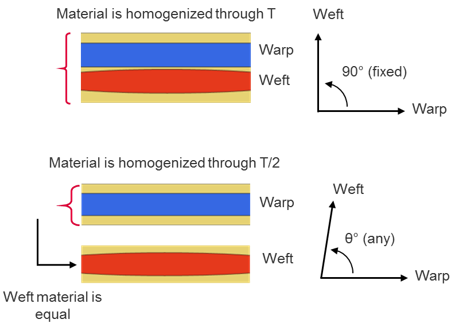

Woven
| Homogenization Scale | Comment |
| Homogenization of matrix, tows in warp and weft directions. This scale is supported by the homogenized weave ply type. | Impractical to drape - any deviation from θ=90° is new
anisotropic material. Cannot distinguish between ply level fiber and matrix direction results. |
| Homogenization of matrix and tows in just one direction. This scale is supported by the unidirectional weave ply type. | Weave modeled internally as four uni plies with ¼ T. The
stacking sequence is [θ/ θ+90/ θ+90/ θ]. Same material when θ changes. HyperMesh also uses this methodology when importing woven plies from external composite data. |
