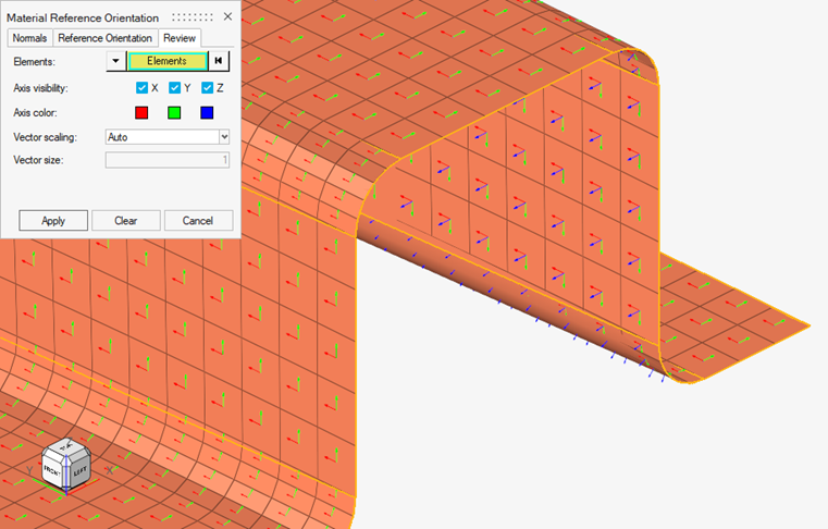

Material Reference Orientation
Material reference orientation of composite laminates.
The material reference orientation of a composite laminate defines zero degree fiber direction from which ply orientations rotate. Visualizations are performed using the Material Reference Orientation dialog.
- From the Composite Browser, right-click the white space and select from the context menu.
- In the dialog, click the Material System tab.

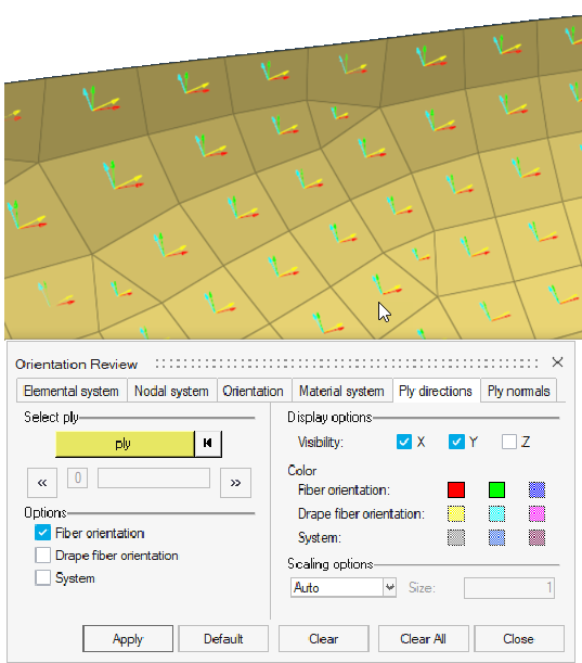

Ply Direction
Visualize ply directions.
Ply directions for both nominal fibers and draped fibers can be visualized.
- From Composite Browser, right-click the white space and select from the context menu.
- In the dialog, click the Ply directions tab.

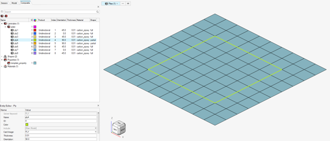

Ply Shape
Visualize ply shapes.
To visualize ply shapes boundaries of selected plies in the modeling window, select a ply entity in a browser or the modeling window. Its boundaries will be highlighted in the modeling window.

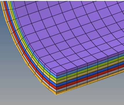

Click
on the View Controls toolbar.
Set the shell thickness
option to 3D.
This will visualize the total thickness on each element.
Set the
ply layer and edge option to Ply layers.
This will display the individual layers within each element thickness.
Figure 4.
