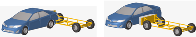

Barrier Positioner
Use the Barrier Positioner tool to automatically get the impact barrier into position, based on the selected crash regulation.
The solver transformation cards are automatically created to move the barrier at the position corresponding to the selected protocol.
The Barrier Positioner tool supports the regulations: Roof Crush, C-NCAP, Euro-NCAP, FMVSS, IIHS, J-NCAP and UN-R for frontal, side and rear load cases.
