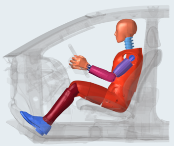

Dummy Positioning
Position a dummy model using the Dummy Browser.

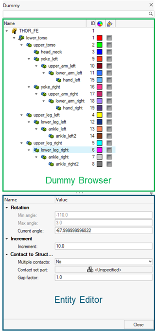

Dummy Browser
Overview of the Dummy Browser.
This browser is compatible with all LS-DYNA, Radioss and PAM-CRASH Humanetics dummies (encrypted or not encrypted) and also with LSTC dummies.
You can undo and redo actions made in the browser using the Undo and Redo commands on the Restore toolbar.
| Column | Description |
| Entity | List of the dummies and dummy bodies. |
| ID | Displays the dummies and bodies IDs. |
| Color | Displays the body entity colors. Body color is different from the component color defined in the Model Browser. The body color is activated when a body is in Review mode or when display mode is set on “By Body”. |
Entity Editor
The Entity Editor is used to assign, modify and quickly view the attributes defined inside Dummy Browser entities.

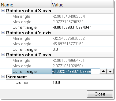

The Entity Editor is also used to modify the position of bodies. You can directly define the angle of rotation to apply in each axis of rotations in which the selected body is able to move.

The Dummy (
) is the root of the
hierarchy in the Dummy Browser. A dummy is defined by bodies
) representing the
different kinematic assemblies of the dummy.

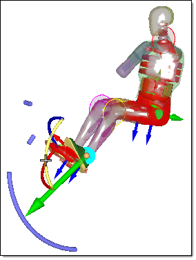

- In the Dummy Browser, select a body.
In the graphics area, click-and-drag the manipulator to interactively modify
the position of the selected body.

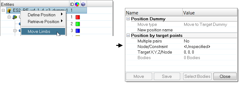

In the Dummy Browser, right-click on a body and select
Move Limbs from the context menu.
The Entity Editor opens.

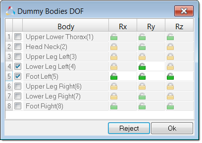

Click Select Bodies to open the Dummy Bodies
DOF dialog and select the bodies and degrees of freedom of the
active bodies that will be able to move during automatic positioning.
Select bodies by activating their corresponding checkbox, or picking them in the graphics area (right-click or left-click to activate/deactivate a body). Lock/unlock degrees of freedom by clicking the lock icon, or by picking the DOF arrows in the graphics area (right-click or left-click to activate/deactivate a DOF).

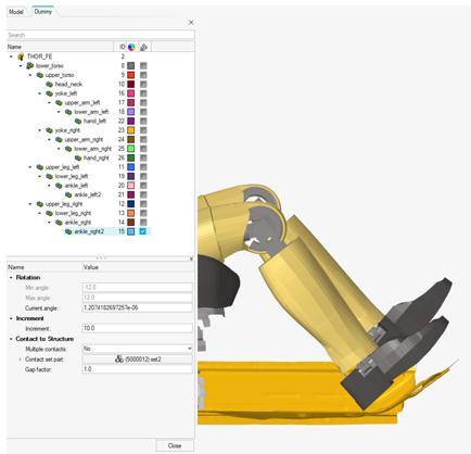

Contact Detection with Surrounding Components
Auto-contact detection allows you to automatically detect contact between dummy limbs and surrounding structural components during the positioning process. Limb motion is automatically stopped on contact detection.
- In the Dummy Browser, select the dummy body.
- In the Entity Editor, select either single contact or multiple contacts that need to be defined by setting Multiple contacts to Yes or No.
- For each contact, create and assign a set of components in the Contact set part field.
- In the Gap factor field, type in an appropriate scale factor.
Click Close.
The Contact checkbox is activated for the selected dummy body indicating the contact check is active.

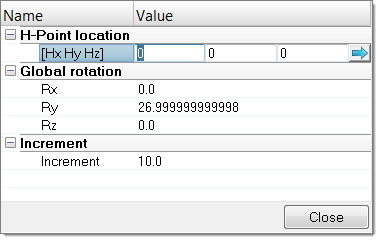

- In the Dummy Browser, right-click the dummy root name and select Dummy Testdata Positioning from the context menu.

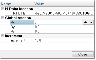

- Define H-Point location coordinates of the dummy H-Point.
- Define the Rx global dummy rotation value around the global X-axis.
- Define the Ry global dummy rotation value around the global Y-axis.
- Define the Rz global dummy rotation value around the global Z-axis.
