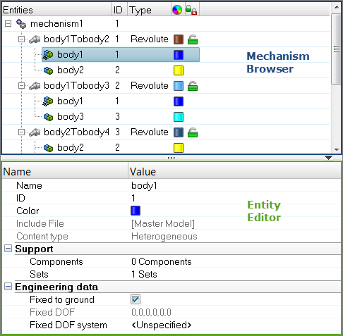

Entity Editor
The Entity Editor is used to assign, modify and quickly view the attributes defined inside Mechanism Browser entities.
For example, once you create a new body or select a body in the browser, the Entity Editor opens and displays the bodies corresponding attributes, which you can view and modify.

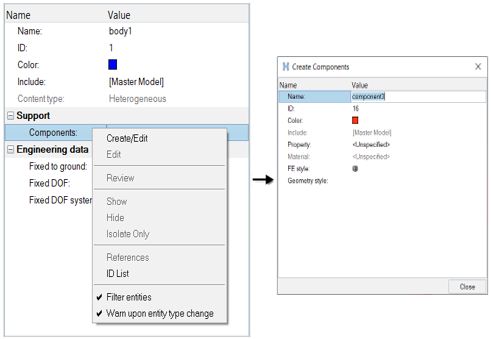

- Bodies (
) define
a kinematic assembly made of FE parts or nodes, which can be selected in the
Entity Editor. To create a body, right-click on

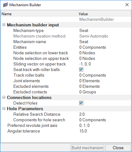

Create a Mechanism
This task explains how to create a mechanism.
There are two ways to create a mechanism: Manual and Auto Generate. In this task, you will create a mechanism using the Auto Generate method.
- Using the Manual approach, you create the mechanism manually by defining the bodies and joints.
- Using the Auto Generate approach, HyperMesh will automatically create bodies and joints based on a selection of components and elements of the FE model.
Mechanism Builder Options Table
Use this table to set options for the Mechanism Builder.
| Mechanism Builder Options | |
| Option | Action |
| Mechanism Type | Select the type of mechanism, either Seat or General. Your selection will affect other options in the dialog. |
| Mechanism Name | Type the name you want to give to the mechanism after the extraction is completed. |
| Entities | Select the FE components that define the mechanism. You can choose Components, Mechanisms, Assemblies or Sets. |
| Node Selection on Lower Track | When the Mechanism Type is set to Seat, you can select nodes on the lower track components of the seat. |
| Node Selection on Upper Track | When the Mechanism Type is set to Seat, you can select nodes on the upper track components of the seat. |
| Sliding Vector on Upper Track | When the Mechanism Type is set to Seat, you can specify the translation direction of the joint defined for the seat track. |
| Seat Track with Roller Balls | When the Mechanism Type is set to Seat, you can specify whether the seat track contains roller balls. If you check this option, HyperMesh will automatically create a double slider joint for the seat track, and an additional selector for the seat track roller will appear. |
| Track Roller Balls | When the Mechanism Type is set to Seat, and Seat Track with Roller Balls is checked, this option allows you to select the roller ball components that will be defined as third body in the double slider joint. |
| Joint Elements | Select the FE elements (springs or beams) that have to be created as joints in the mechanism extraction process. |
| Excluded Elements | Select the FE elements that should be excluded from the extraction
process of the mechanism. For example, nodal rigid bodies that are used to link components in the FE model but that are not physical conditions, can be selected here and will not be considered in the extraction process. |
| Excluded Contacts | Select to exclude tied contacts that may be defined on the FE model but do not represent physical connections. This excludes them from the extraction logic. |
| Detect Holes | Select to activate the hole detection parameters. This allows you to detect joint positions by looking for concentric holes in components. |
| Relative Search Distance | When Detect Holes is checked, this option defines the distance of search for concentric holes that define a joint location. |
| Components for Hole Search | When Detect Holes is checked, this option allows you to select the components on which the hole detection must be performed. |
| Preferred Revolute Joint Axis | Type the vector that defines the revolute joint axis. This will overwrite the direction of the joint elements. |
| Angular Tolerance | Type the angular tolerance into this field. The joint axis within this angle will be overwritten by the Preferred Revolute Joint Axis value. |

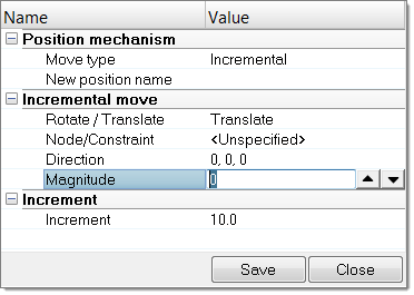

- Choose Translate to open the Entity Editor and select a Node/Constraint, give a
Direction of motion, and define the Magnitude of the translation to
apply.The Magnitude can also be modified, using the up and down arrow buttons. Moreover, you can control the increments of the operations by changing the Increment value.

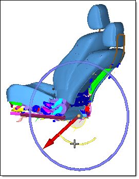

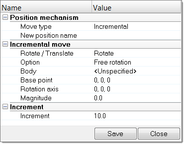

- Choose Rotate to open the Entity Editor, select a Body, define a Rotation axis, a
rotation center (Base point), and provide the Magnitude of the rotation to
apply to the body.The Magnitude can also be modified, using the up and down arrow buttons. Moreover, you can control the increments of the operations by changing the Increment value.
Figure 6.

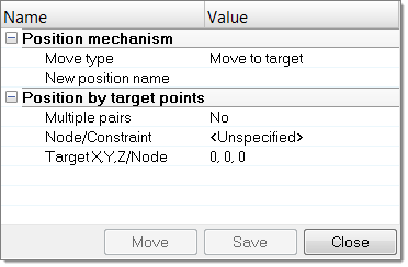

- Choose Target Point to open the Entity Editor, select a Node and define its Target
location. Click Move to calculate the position of
each body to bring the selected node to the target location or the nearest
location, depending on joints limit values.This option can be applied on a set of nodes and targets, by setting Multiple pairs to Yes.
Figure 7.

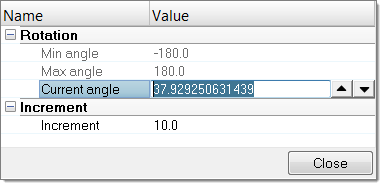

- In the Entity Editor, modify the Current angle
of the joint.

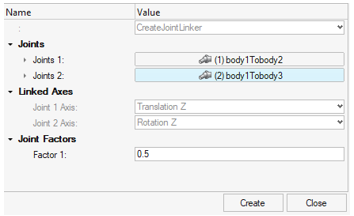

Joint Coupling
Joint coupling provides functionality that allows you to create a gear joint (coupling between two revolute joints), or a rack and pinion joint (coupling between a slider joint and a revolute joint).

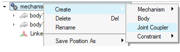

To create a joint coupler, right-click on the mechanism and select from the context menu.
Figure 11.
In the Entity Editor under Joints, select the two
joints to link.
Figure 12.
- Under Joint Factors, in the Factor 1 field, enter an appropriate multiplication factor.
- Click Create.

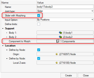

Joint with Morphing

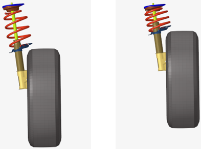

When creating slider joints, you can select additional components that will be automatically morphed along with the motion of the selected bodies.
- To activate the joint with morphing functionality, from the Entity Editor, check the Slider with Morphing checkbox.
Under Support, select the components you want to morph in the Component to
Morph field.
Figure 14.
- Click Create.

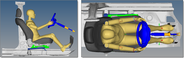

Link a Dummy to a Mechanism
In a vehicle FE model, quickly and efficiently set kinematic systems such as seats, steering wheels and pedals in different positions using the Mechanism Browser.
- In the Mechanism Browser, right-click on the seat mechanism and select Link to Dummy from the context menu.
- In the Dummies dialog, select a dummy to link to the seat mechanism and click Next.
In the Mechanism bodies (Main body) dialog, select the
main body from the seat and click Next.
Note: For this use case, it is common to select a seat cushion.
In the Dummy bodies (child bodies) dialog, select the
dummy secondary bodies and the linked degrees of freedom and click
Close.
Note: For this use case, it is common to link to the lower torso of the dummy in degrees of freedom Tx, Ty, and Tz (selected per default).
- To fix some of the bodies of the dummy, for example, hands and feet, define constraints on those bodies by selecting or Point Location from the context menu.
Position the seat mechanism.
The position of the dummies limbs will be automatically updated.
