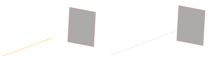

If the Follow curvature option is selected, the extended line follows the input line curvature. If left unchecked, a straight-line extension is created.
- Activate the Choose target checkbox to extend the
line to a target point, node, line, or surface.
Specify the range that the extended line must fall within to connect to the target geometry using capture radius microdialog. If the end of the extended line is within the capture radius of the target geometry, then the coordinates are mapped to the target geometry.
