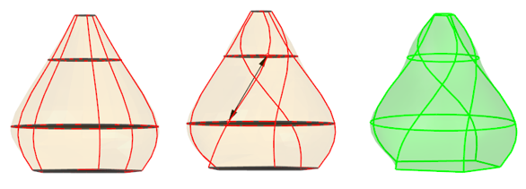

Create a link between input surfaces by specifying two end points. A pair may not skip any surface in between. For instance, if surfaces 1, 2, 3 and 4 are defined in that order as the input surface list, a link can be defined from surface 2 to 3 but not from surface 2 to 4. If such a link is detected, it is ignored. One point may be linked to multiple points, which results in the creation of triangular surfaces. Point links are show graphically as arrows below. Figure 4.
