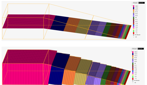

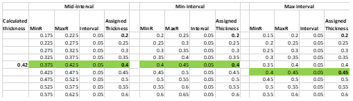

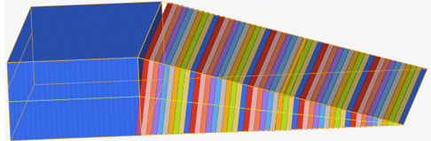

- Group elements by thickness interval
- Automatic Method
- Groups elements with similar thicknesses together, and assigns an average thickness to the groups based on the “Factor of thickness” interval range input.
- Method Fixed Interval
- Control thickness properties at constant intervals.

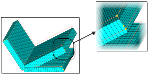

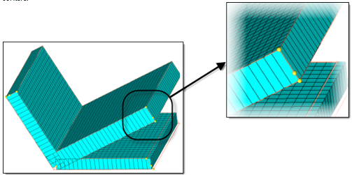

- Scaling at corners [0,10]
- Enter a scaling factor to use when interpolating thickness values near
t-junctions or corners. A value less than 1 will result in linear
decrease in the thickness values nearer to the junction/corners. A value
of zero will result in an approximate mass-conserved thickness
estimation. When equal to 1, the thickness is extrapolated /
interpolated without any scaling. When greater than 1, the thickness
will increase as you go closer to the junction.
