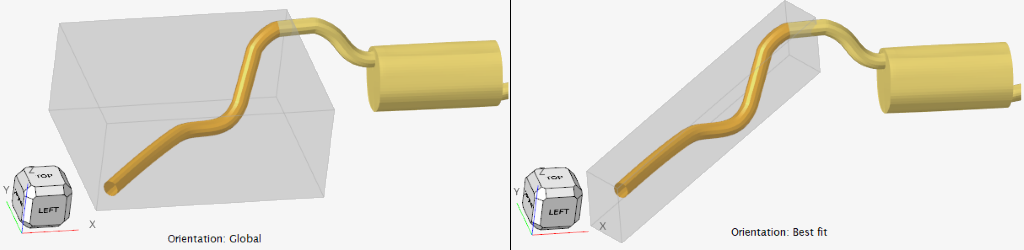

Option Description Displayed elements To add a box volume to the currently displayed elements, select one of the box icons in the pallet. Select elements To add a box volume to a selected subset of elements: - Click By elements at the bottom of the pallet.
- Select elements.
- Use the drop-down menu to orient the box with the global axes or
to a best fit.

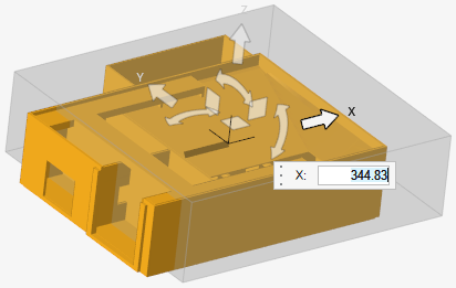

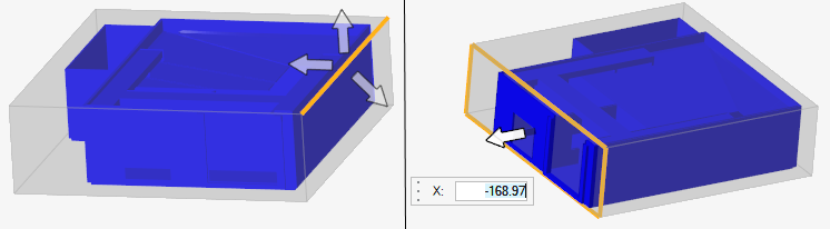

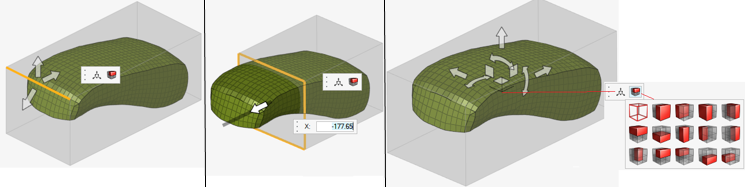

Resize or reorient and relocate the box.
You can change the box type so that it fits specific regions. If the type is modified, the box gets re-drawn accordingly based on your element selection.To access the box editing micro, you have to select an edge or a face.
