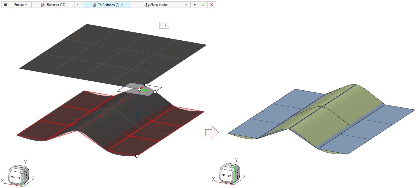

- To Surfaces
- Select To Surfaces to project entities onto a surface along either a user-defined direction or the normal to the surface.
- In the modeling window, select one or more surfaces.
- Click
Figure 10.

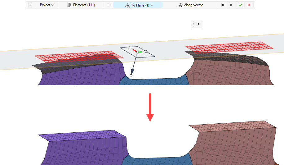

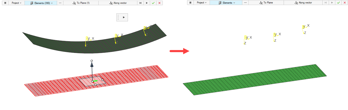

- To Plane
- Select To Plane to project entities onto a plane along a user-defined direction.
- In the modeling window, select a plane and
use the Plane tool to project.
The plane could be aligned to a surface/mesh/nodes, and so on.
- Click
Figure 11.
Figure 12.
