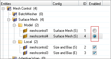

In the Mesh Controls Browser, enable and disable mesh
controls.
| Option | Description |
| Model mesh controls | Multiple instances of model mesh controls can be defined, but only
one can be enabled.

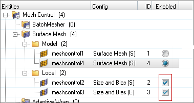

| Local mesh controls | An unlimited number of local mesh controls can be defined and
enabled.
