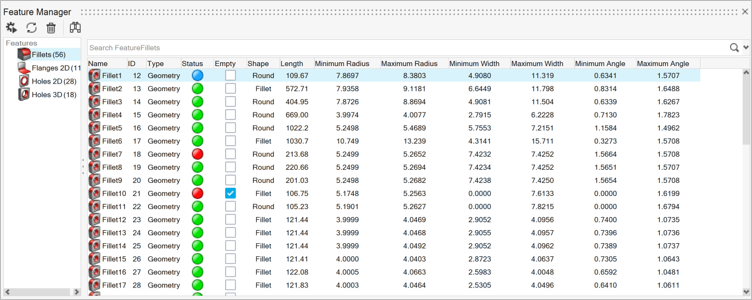

Once the detection process is completed, the Feature Manager table opens.Figure 4.
Use the Feature Manager to select, review, and edit the detected
features.
By now, the feature entities are already in the model and can be also accessed via the Model Browser or by selecting them directly in the modeling window.The Feature Manager uses the same search, filter, and sorting mechanisms as the Model Browser.

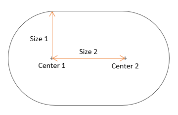

- Rounded
Figure 7.

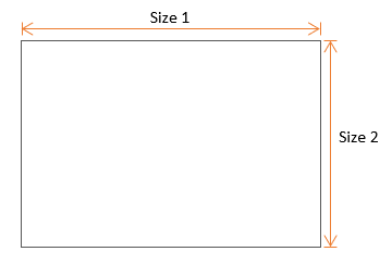

- Rectangular
Figure 9.

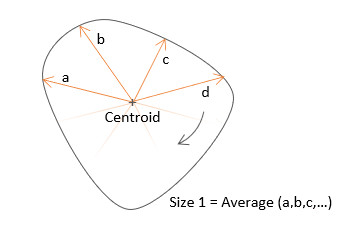

- General
Figure 10.

Fillets
Fillets can be curved rounds (exterior) or fillets (interior) connecting surface edges in place of a corner. Their measured dimensions are minimum and maximum radius, minimum and maximum width, and minimum and maximum angle.
