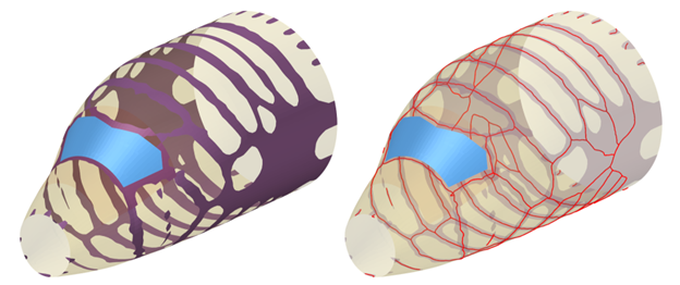

When combined with the Categorize tool, the Extract Line tool can be used to streamline the reduced-order model-building process, as shown in Figure 1.
In this example, the input is the skeleton set generated by the Categorize tool. During processing, any holes in the input will be patched. Line Extract can be applied to detailed models, as demonstrated in Figure 2.
It is also valuable for interpreting both 2D and 3D topology results. For instance, Figure 3 shows how the Line Extract capability is used to extract a mid-line from a 2D topology result, which can be helpful in interpreting ribs and structural features.
