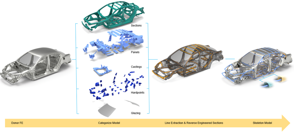

Use the Categorize tool to streamline the development of reduced order models by automating the detection and categorization of subsections within an automotive model.
It classifies these subsections into four groups: Skeleton, Panels, Castings, Glazings, and Hardpoints, organizing the content into corresponding sets.
After categorization, the next step in creating the reduced order model is extracting a mid-line representation from the skeleton subsection. Once this mid-line is created, the final step is to use skeleton absorb, which converts the mid-line input into a 1D mesh with detailed beam sections applied. The accuracy and organization of these sets are critical, as cleaner categorization reduces manual intervention and clean-up times in later stages, particularly during the line extraction and absorption phases.
