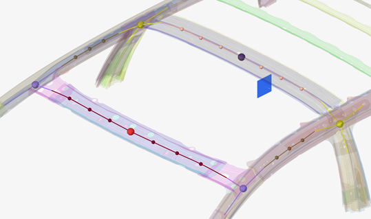

Create panels in one of two ways:
Option Description Automatically Select three or more members which form an enclosed loop. Figure 2.
Using existing parts Check Use Existing then select the components or elements to be considered as a panel. In both cases the panel is connected to the members and joints via spring elements. -

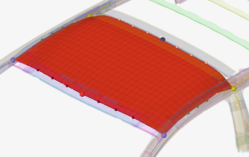

Figure 3. Without offset

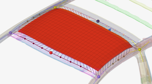

Figure 4. With offset
