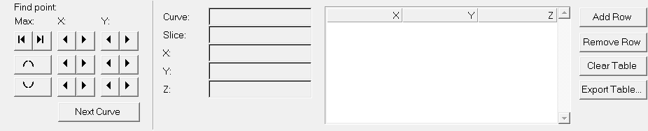

Query XYZ Values Using the Values Panel
From the 3D Chart ribbon, click the Values tool.
Figure 6.

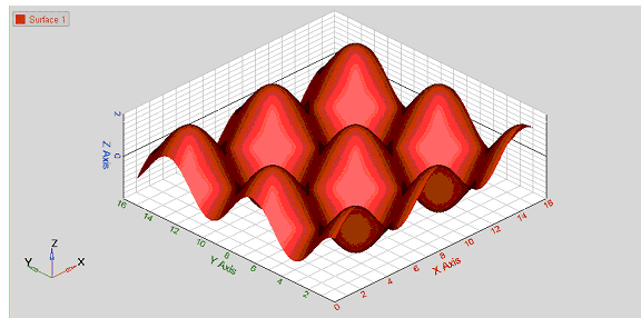

Note: A bubble with the XYZ values is seen in the graphics area. -
Click the surface to see the XYZ values at that point.
Note: The panel area displays the XYZ values of the point chosen.

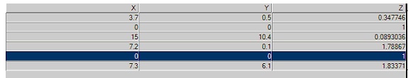

- Click Add Row to add an additional row.
Click on another point on the surface.
The value in the newly added row is updated to that of the new point.
Repeat the operation to build a table.
Figure 7.
- Click any one of the rows in the table and click Remove Row.
- Click Export Table… and save the table as a DAT file.

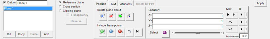

Use Datum Planes as Reference Planes
From the 3D Chart ribbon, click the Datums tool.
Figure 8.
- Verify that the Position tab is active and the radio button for Reference Plane is checked.
Click Add to add a datum plane as a reference plane.
By default, a reference plane is created in the Z plane.
Move the slider bar in the panel area to move the reference plane along the Z
plane.
Figure 9.
Click the icons
and
to change the orientation of the plane along the X and
Y axis, respectively.
Click
to create a plane with three points of your
choice.
Figure 10.
Under Location, enter 1 for the X, Y, and Z axis,
respectively.
You can also pick three points from the screen.
- Click Apply.
Click
and
to move the reference plane to the maximum and minimum
point in the surface plots, respectively
Click the arrows,
, to move to the next/previous point or to the local
maximum/ local minimum along the X and Y axis.

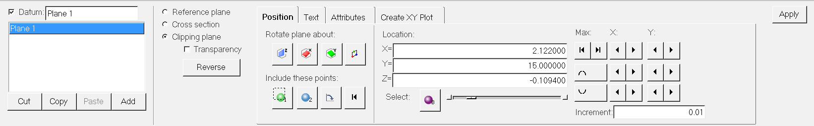

Use Datum Planes as Clipping Planes and Plot Cross Section

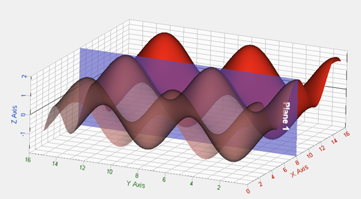

- Create a Reference plane parallel to the Z-axis by selecting Rotate plane about X. Move the slider bar to position the datum plane in the middle of the surface plot.
- Activate the radio button for Clipping Plane.
Activate Transparency.
The clipped part of the surface plot appears transparent on the screen.
Move the slider bar and note the change in the clipping area from the
screen.
Figure 11.
- Turn the Transparency option off.

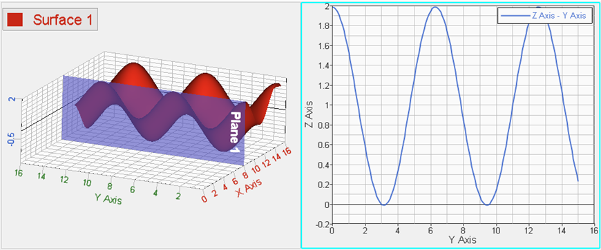

- Click the Create XY Plot tab.
- Verify that the option for Place curve on is set to New plot.
- Set Create curve: to Y vs Z.
Click Plot Data.
Figure 12.
- Click the Position tab.
Move the slider bar to update the position of the clipping plane.
The plot updates simultaneously.
- Click the plot window to make it active.
Click the Fit icon,
, to fit the plot to the window.
