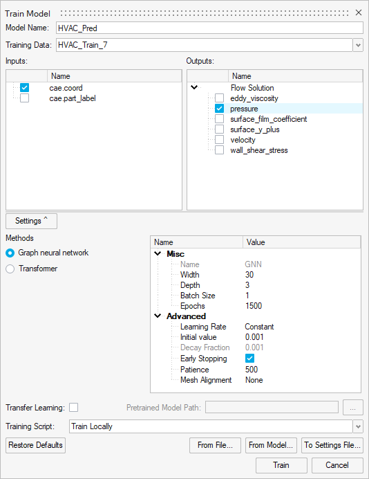

From the PhysicsAI ribbon, select the Train
an ML Model tool.
The Train Model dialog opens. -

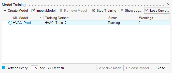

Define the training details and click Train.
Review the status in the Status column.
Tip: Once the status changes to Running, you can view the training logs by clicking Show Log.

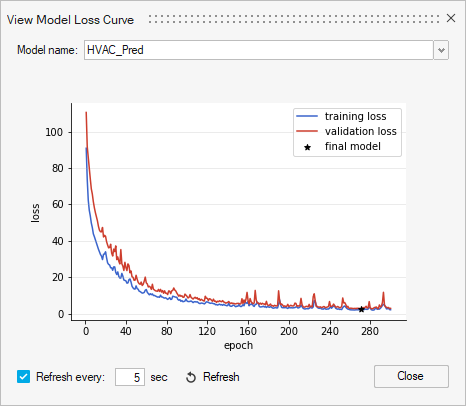

- Optional:
Click Loss Curve to view the training of a validation
loss curve.
The curves are useful to visualize the progress of the training process. In a well fit model, the training and validation losses become nearly identical. If validation never approaches the training loss, this is indicative of underfitting; increased training time can leave files d to improved model performance. A validation loss that approaches the training loss but diverges higher likely indicates overfitting; the point of low validation loss is the ideal model to avoid loss of generalization.Note: The validation curve only appears if there are at least 15 samples.
Figure 7.
