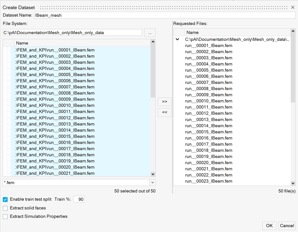

  1. From the PhysicsAI ribbon, select the Create Dataset tool.
    The Create Dataset dialog opens.
  2. For Dataset Name, enter Ibeam_mesh.
  3. For File System, click and navigate to the Mesh_only_data folder.
  4. Change the filter from *.h3d to *.fem.
  5. Select and transfer all of the .fem files.
  6. Select Enable train test split check box and enter 90 for the Train %.
  7. Clear the Extract solid faces and Extract Simulation Propertiescheck boxes.
    Figure 3.
  8. Click OK.
    The dataset is extracted and the Datasets dialog opens.
  9. Click Close.

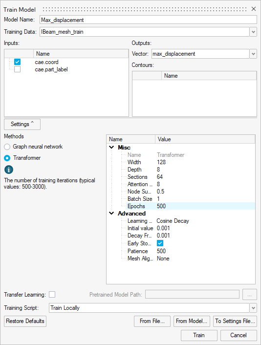

  1. From the PhysicsAI ribbon, select the Train an ML Model tool.
    Figure 4.
    The Train Model dialog opens.
  2. Define the following details and click Train.
    1. For Model Name, enter Max_displacement.
    2. For Inputs, select cae.coord.
    3. For Vector, select max_displacement
    4. Under Method, select Transformer.
    5. Change the number of Epochs to 500.
    Figure 5.

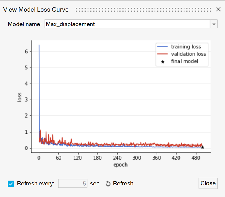

  3. Once the training is complete, click Loss Curve to see if the model has converged after 500 curves.
    Figure 6.
