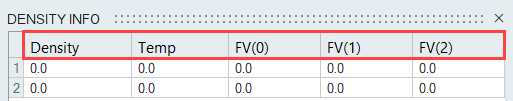

Figure 1. Density Info for ABAQUS_MATERIAL
- Certain control cards make use of unstructured tables. In these cases, array
attributes are shown as new categories/columns and data cannot be
imported/exported.

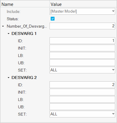

Turn fields on and off in the Entity Editor.
Option Description Turn field off Remove its corresponding value or select OFF from the drop-down list. If you hover over a field that is turned OFF, its default value will appear in the Value column.
Turn field on Enter a new value or select a value from the drop-down list. When a field is turned ON, its corresponding value will always be displayed in the Value column.

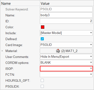

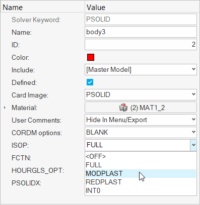

In the example below, assume that initially the field ISOP is turned OFF and has a default value of FULL. To turn the field ON, click its corresponding Value field and select a value from the drop-down list. If you want to turn the field OFF, select <OFF> from the drop-down list.Figure 3. ISOP Field Off

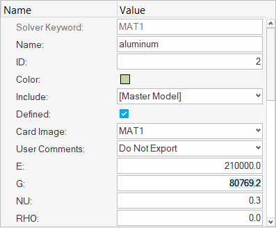

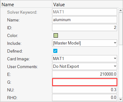

In the example below, assume that initially the field G is turned OFF and has a default value of 80769.2. To turn the field ON, click the Value field and press Enter. To turn the field OFF, delete the value and press Enter. If you turn the field OFF, the Entity Editor will retain the previous value you specified.Figure 5. NU Field Off

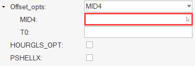

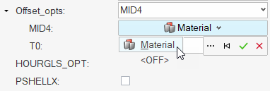

In the example below, assume that initially the field MID4 is turned OFF. You can turn the field on and then assign it a material. To turn the field ON, click its corresponding Value field. You can then use the entity selector to select a material to assign to the field. If you want to turn the field OFF, click the drop-down menu on the entity selector and select <OFF>.Figure 7. MID4 Field Off
Figure 8. MID4 Field On

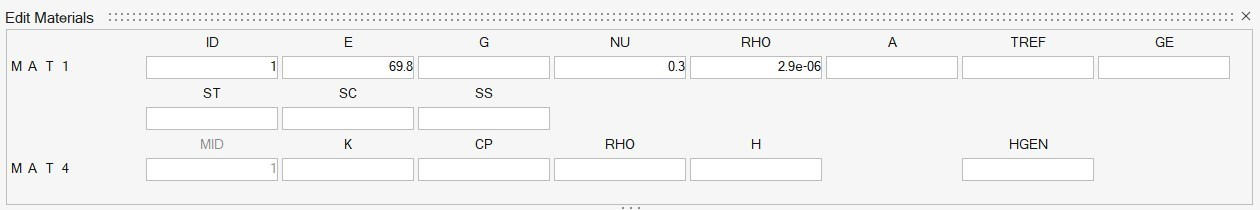

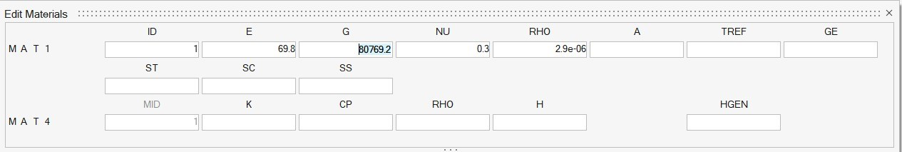

In example below, the card image MAT1 is displayed for a material in OptiStruct. By default, the field G is turned OFF. To turn the field ON, click its field header. The default value is displayed in the field heading.Figure 9. MAT1 Card Image with the Field G Off
Figure 10. MAT1 Card Image with the Field G On

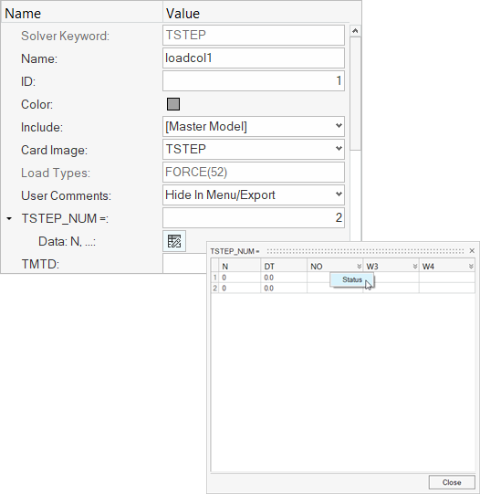

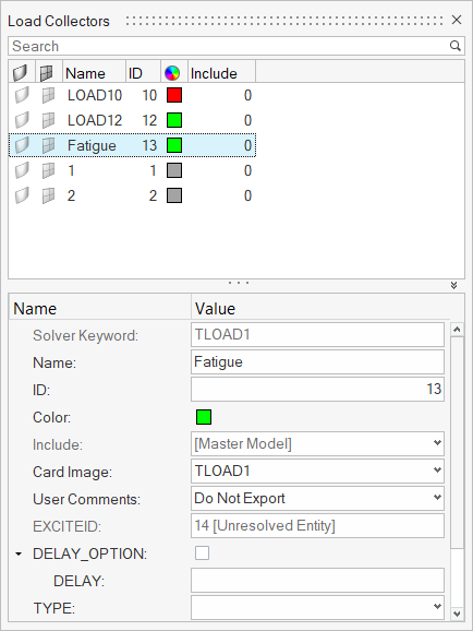

When defining data in tables, certain fields can be turned ON and OFF. To turn a field ON, right-click on the heading of the disabled field and select Status. In the image below, the NO field is being turned ON for the load collector TSTEP.Figure 11.

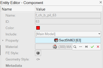

Assign Entities
In the Entity Editor you can assign certain entities to another entity or a group of entities.
For example, you can assign a property to a component. When an entity has an entity assigned to it, the name and ID of the assigned entity will be displayed in the Value field. If an entity does not have an entity assigned to it, the Value field will display <Unspecified>.
If available, you can expand a drop down menu on the entity selector to view more entity types.

Resolve Unresolved Entities
Right-click on an unresolved entity, or click
, then select Clear unresolved
entity from the context menu.
- Click the entity's Value field.
- Use the entity selector to choose a new entity.
