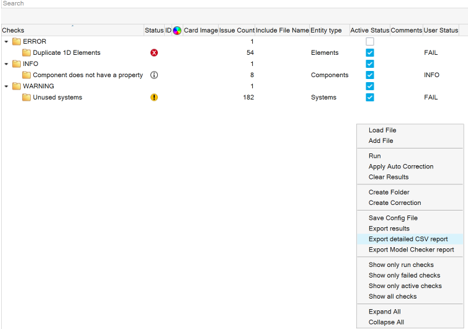

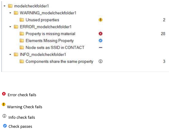

A list of failed checks display, along with the entities in your model that failed the check.Figure 1.
Perform correction.
- Perform automatic correction by right-clicking on the failed check or failed entity and select Apply Auto Correction from the context menu.
- Perform manual correction by right-clicking on the failed check or failed entity and select Apply Manual Correction from the context menu.
- Optional: Export a detailed report of the checks that were run by right-clicking in the white-space of the Model Checker and selecting Export Results from the context menu. You can export all columns by selecting Export detailed CSV report.
