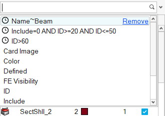

Perform an Advanced Search Using Auto-Completion
Interactively build search strings using a dynamic suggestion list.
  1. Access the list by clicking the text field of a browser search bar.
  2. Select attributes, operators, and values to append the correct syntax to the search string.
    The search syntax follows this basic form: <attribute> <operator> <value>.

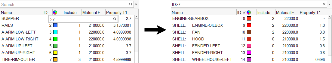

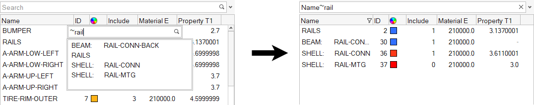

Use Column Filters to Build a Search
Use column filters to quickly search any attribute that is added to a browser as a column.
  1. Hover over a column name then click the filter icon .
  2. Type a value or select from the suggestion list then press Enter or click .
    The value entered is converted to the correct syntax and shown in the search bar.
    Figure 4.
    You can also use operators in the column filter to refine the search.

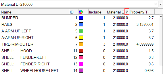

    A column filter icon indicates the column on which the filter is applied.
    Figure 6.

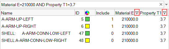

    Multiple column filters can be applied. The search string is appended in the search bar.
    Figure 7.

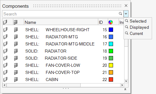

Use Predefined Filters to Build a Search
Use predefined filters to quickly filter the browser contents with selected or displayed entities
Predefined filters are supported in Model Browser entity views, the Part Browser, and the Subsystem Browser.
  1. Access the list of predefined filters by clicking the drop-down button next to the search icon.
    Figure 8.
    • Selected - Filters the browser with just the selected items. The Selected filter works for selection in both the browser and the graphics and should be reapplied after appending an existing selection.
    • Displayed - Filters the browser with entities that are displayed in the graphics. When the Displayed filter is applied in a browser, the filtered results are automatically updated upon changing the display state of the selected entities.
    • Current - Filters out the current collector.

Access Recent Search Strings
Click the text field of a browser search bar.
Your recent searches are indicated by the icon.
Figure 9.
Clicking on a recent search string auto-applies the filter and shows the search string in the search bar.
Clicking Remove removes the selected search string from recent history.
Note: A maximum of 5 recent searches are shown. Remove the latest strings to see previous search strings.
