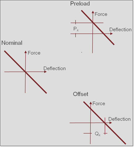

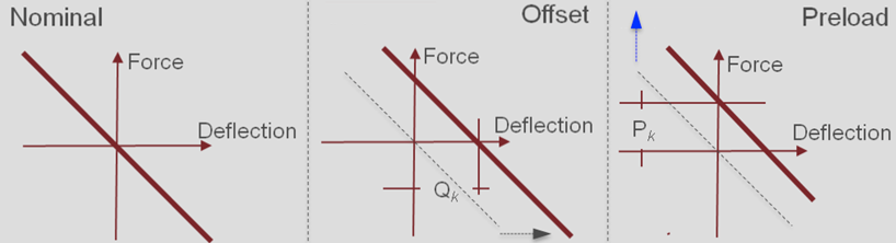

The following figure shows the effect of preload and offset on a bushing:
2.
