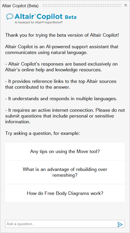

Start Altair Copilot
  1. In the upper-right corner of the application window, click Altair Copilot (Beta) , or click View > Altair Copilot (Beta).
  2. In the Ask a question field, enter a question and press Enter or click the Send button to submit it.
