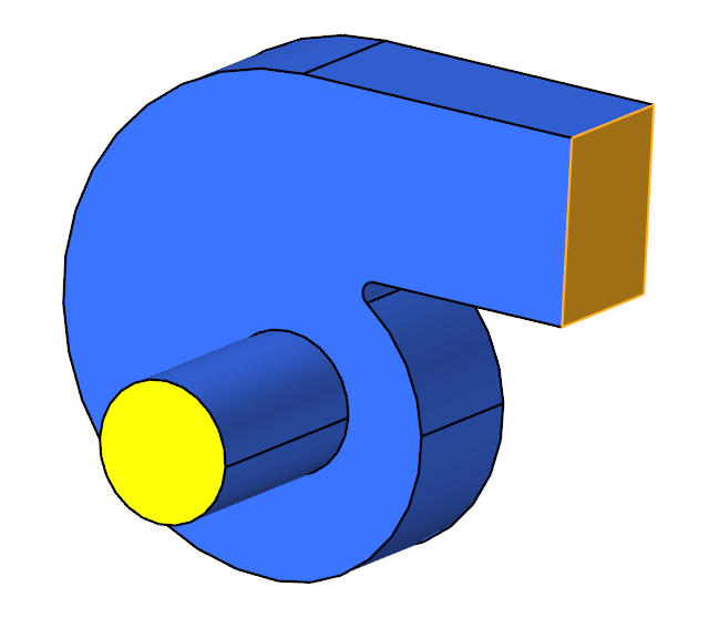

The problem to be addressed in this tutorial is shown schematically in Figure 1 and Figure 2. It consists of a centrifugal blower with a wheel of forward curved blades, and a housing with inlet and outlet ducts. The fluid through the inlet plane enters the hub of the blade wheel, radially accelerates due to centrifugal force as it flows over the blades, and then exits the blower housing through the outlet plane. Because they're relatively cheaper and simpler than axial fans, centrifugal blowers have been widely used in HVAC (heating, ventilating, and air conditioning) systems of buildings.
Figure 1. Schematic of Centrifugal Blower
Figure 2. Schematic of Fan Blades

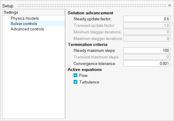

  3. Click the Solver controls setting and verify that the parameters are set as shown in the figure below.
    Figure 7.

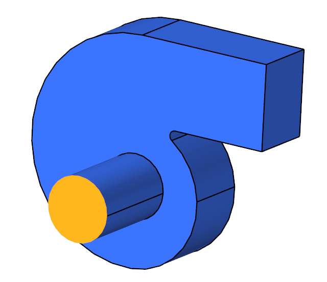

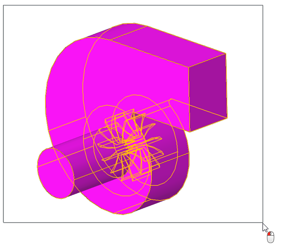

  1. Hide the housing solid.
    1. Set the entity selector to Solids.
    2. Select the centrifugal housing.
    3. Right-click and select Hide from the context menu or press H.
    Only the solid for the centrifugal blower displays in the modeling window.
    Figure 10.

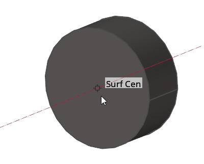

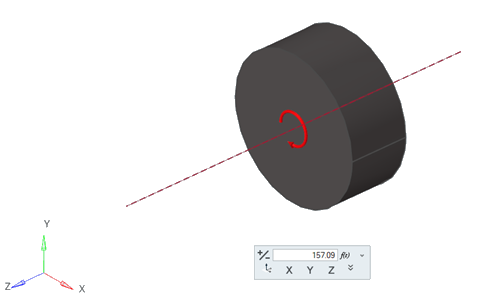

  5. On the guide bar, click Axis.
  6. Define the axis of rotation.
    1. Use the Surf Center snap point to place the axis in the middle of the centrifugal blower.
      Figure 12.
    2. In the microdialog, click Z to align the axis with the global z axis.
    3. Click to flip the spin direction.
    4. Enter a value of 157.09 in the text field.
      Figure 13.
  7. On the guide bar, click to execute the command and exit the tool.

  1. From the Flow ribbon, Pressure tool group, click the Stagnation Pressure tool.
    Figure 14.
  2. Click the face of the inlet.
    Figure 15.

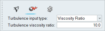

  3. In the microdialog, click the Turbulence tab.
  4. Set the Turbulence input type to Viscosity Ratio.
  5. Set the Turbulence viscosity ratio to 10.
    Figure 16.

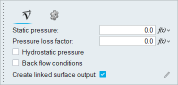

  10. In the microdialog, make sure both Static pressure and Pressure loss factor are 0.
    Figure 19.
  11. On the guide bar, click to execute the command and exit the tool.

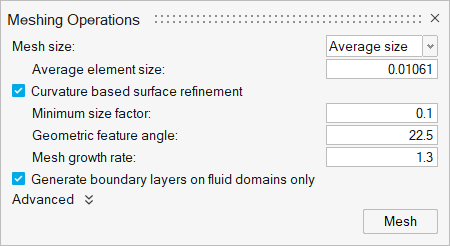

    Note: If the model has not been validated, you are prompted to create the simulation model before running the batch mesh.
  2. Check that the Average element size is 0.01061.
  3. Accept all other default parameters.
    Figure 21.
  4. Click Mesh.

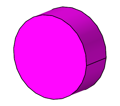

    The solid for the centrifugal blower should be displayed in the modeling window.
    Figure 22.

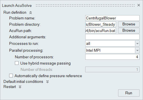

  8. From the Solution ribbon, click the Run tool.
    Figure 25.
    The Launch AcuSolve dialog opens.
  9. Set the Parallel processing option to Intel MPI.
  10. Optional: Set the number of processors to 4 or 8 based on availability.
  11. Deactivate the Automatically define pressure reference option.
  12. Leave the remaining options as default and click Run to launch AcuSolve.
    Figure 26.

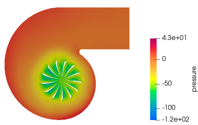

Plot Pressure on a Slice Plane
  1. Navigate to the Post ribbon.
  2. From the menu bar, click File > Open > Results.
  3. Select the AcuSolve .log file in your problem directory to load the results for post-processing.
    The solid and all the surfaces are loaded in the Post Browser.
  4. Click the Slice Planes tool.
    Figure 27.

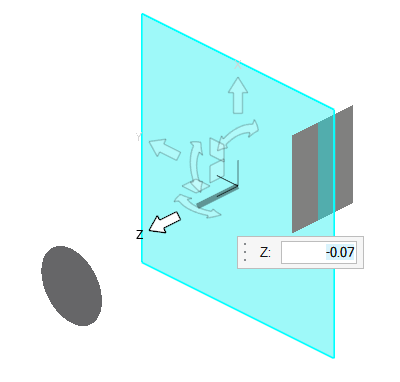

  5. Select the x-y plane in the modeling window.
  6. In the microdialog, click and move the plane along its normal direction a distance of -0.07.
    Figure 28.
  7. Press Esc to exit the Move tool.
  8. In the slice plane microdialog, click to create the slice plane.

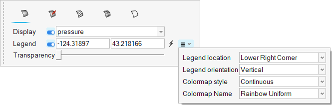

  9. In the display properties microdialog, toggle the Legend radio button.
  10. Click and set the Colormap Name to Rainbow Uniform.
    Figure 29.

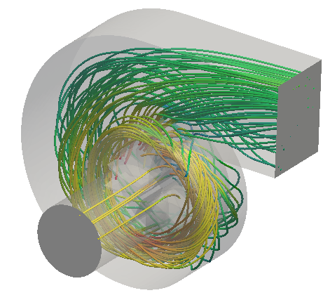

Plot Velocity Streamlines
  1. Hide the slice plane and show the Inlet and Outlet boundaries in the Post Browser.
  2. Click the Streamlines > Circle tool.
    Figure 31.
  3. Select the x-y plane in the modeling window.
  4. In the microdialog, click and move the plane along its normal direction a distance of -0.07.
    Figure 32.
  5. Press Esc to exit the Move tool.
  6. In the slice plane microdialog, click and set the circle radius to 0.1.

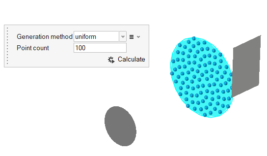

  7. On the guide bar, click Seeds.
  8. In the microdialog, set the Generation method to Uniform and set the Point count to 100.
  9. Click Calculate.
    Figure 33.
  10. In the display properties microdialog, set the Display to Velocity and set the Colormap Name to Rainbow Uniform.
  12. In the Post Browser, show the Auto boundary condition, and then right-click Auto and select Edit.
  13. In the microdialog, adjust the transparency slider until you can see the velocity streamlines.
  14. Click on the guide bar.
    Figure 34.
