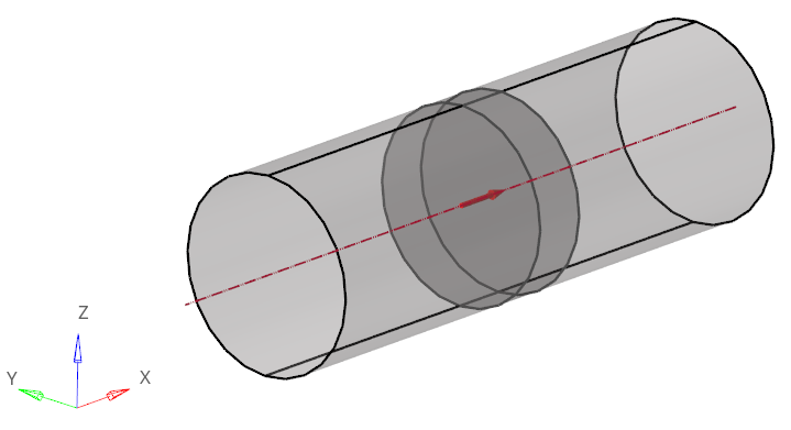

The problem to be solved in this tutorial is shown schematically in the figure below. It consists of an interior fan which rotates at a speed of 377 rad/sec (~3600 RPM) and has a thickness of 0.06 m and a tip radius of 0.11 m. The volumetric flow rate at the inlet is 0.322675 m3/sec (~1212.3 m3/hr). The problem is simulated as a steady state run and the pressure rise across the fan region is computed.

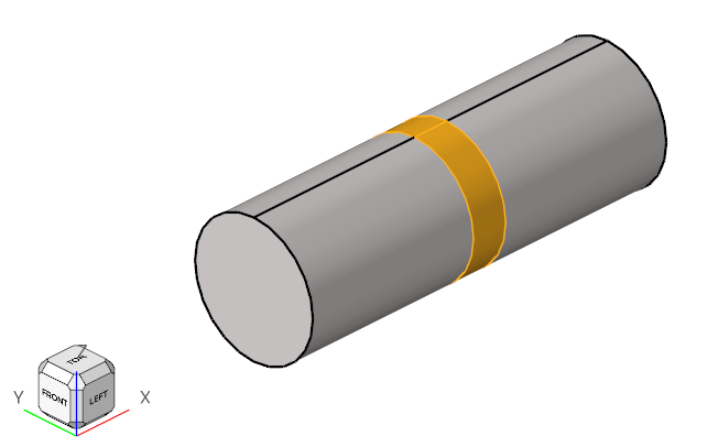

Define the Fan Component
  1. From the Flow ribbon, click the arrow next to the Domain tool set, then select Fan Component.
    Figure 8.
  2. Select the middle solid as the fan component volume.
    Figure 9.

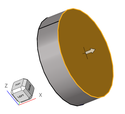

  4. From the View Controls toolbar, change the geometry visualization mode from Shaded Geometry to Transparent Geometry.
    This allows you to view the axis direction vector in the next step.
    Figure 11.
  5. On the guide bar, click Axis.
    In the modeling window, you can see that the axis points in the -X direction.
  6. Click in the microdialog to flip the axis vector to the +X direction.

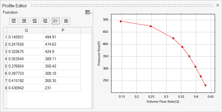

  8. Click beside P-Q Curve Type to open the Profile Editor.
  9. Click , browse to the location where you saved fanPQcurve.csv, and open it.
    Figure 14.
    Note: Units for volume flow (Q) and Pressure Rise (P) are, respectively, m3/sec and Pa.

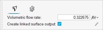

  3. In the microdialog, enter 0.322675 for the volumetric flow rate (m3/sec).
    Figure 17.

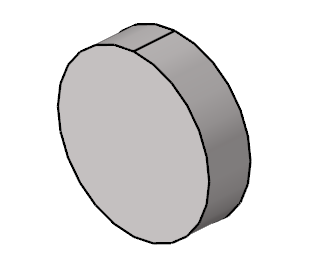

  2. Select the fan component duct marked below to isolate it from front and aft ducts.
    Figure 23.
  3. Right-click and select Isolate from the context menu or press I.
    The solid for the fan component should be displayed in the modeling window.
    Figure 24.

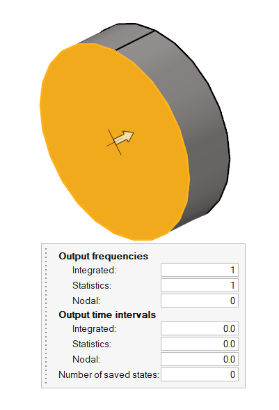

    Figure 25.
  5. Select the front face of the fan and verify that the arrow is heading toward the fan component, as shown in the figure below.
    Figure 26.
  6. On the guide bar, click to execute the command and remain in the tool.

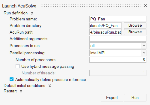

  10. From the Solution ribbon, click the Run tool.
    Figure 28.
    The Launch AcuSolve dialog opens.
  11. Set the Parallel processing option to Intel MPI.
  12. Optional: Set the number of processors to 4 or 8 based on availability.
  13. Leave the remaining options as default and click Run to launch AcuSolve.

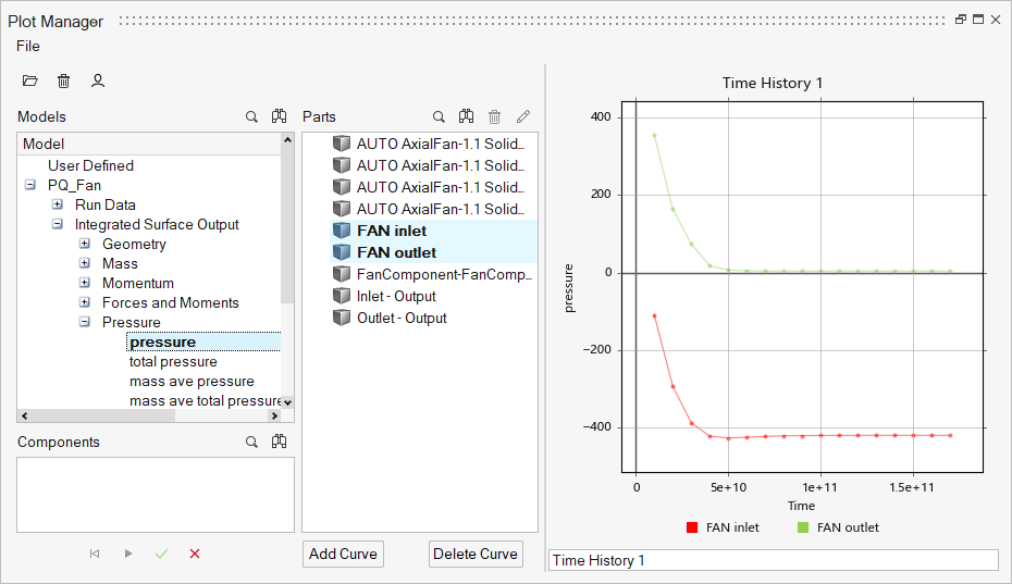

  3. In the Data Tree, expand Integrated Surface Output > Pressure and then select pressure.
  4. Under Parts, select Fan_inlet and Fan_oultet to display pressure at the inlet and outlet.

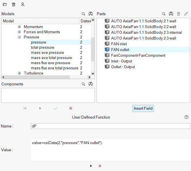

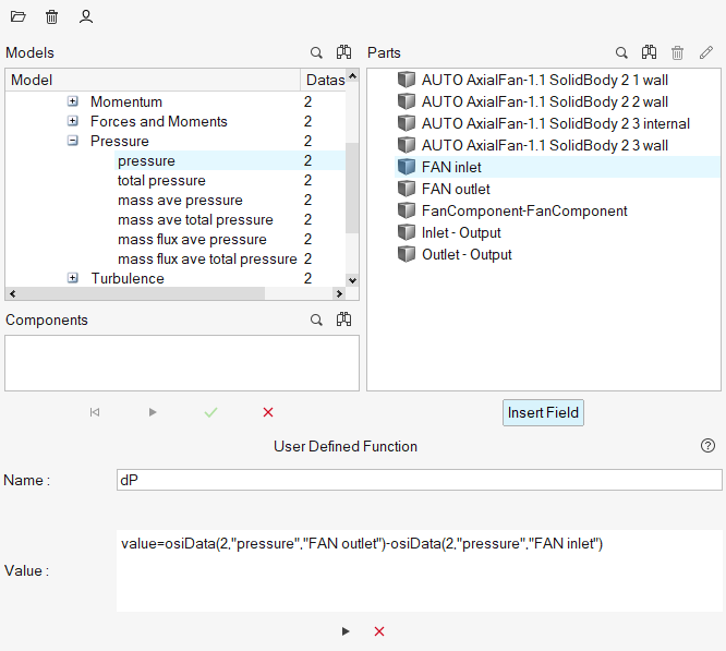

  5. Right-click User Defined under the Model panel to create a user-defined function.
  6. In the Data Tree, expand Integrated Surface Output > Pressure and then select pressure.
  7. In the Name field, enter dP.
  8. In the Value field, type value=.
  9. Under Parts, choose FAN outlet and then click Insert Field to insert the field as part of the value, as shown below.
    Figure 33.
  10. Type - at the end of the user-defined function value.
  11. Under Parts, choose FAN inlet and then click Insert Field to insert the field as part of the value.
  12. Click to add the user defined function.
    Figure 34.

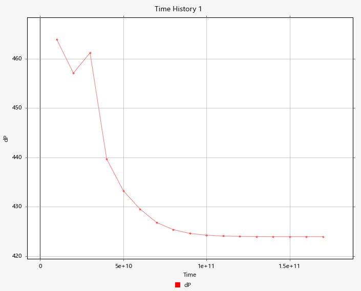

  13. Click the x axis to switch to Time Steps.
    Figure 35.
    From the above figure, the pressure got stabilized at around the 6th iteration and remains constant with pressure difference between the FAN_inlet and FAN_outlet of 423.97 Pa for a given volume flow rate 0.322675 m3/sec, which is very near compared to the reference pressure increase of 424.9 Pa.
