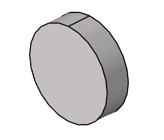

The problem to be solved in this tutorial is shown schematically in the figure below. It consists of an interior fan which rotates at a speed of 377 rad/sec (~3600 RPM) and has a thickness of 0.06 m and a tip radius of 0.11 m. The volumetric flow rate at the inlet is 0.322675 m3/sec (~1161.63 m3/hr). The problem is simulated as a steady state run and the pressure rise across the fan region is computed.
Figure 1 shows a simple axial fan component problem where the fan is an interior fan with thickness “t” and tip radius “r”. In this simulation, flow is passed from the pipe inlet. It enters the fan in an axial direction and exits at the outlet causing pressure rise. This fan pressure rise can be simulated for a given volume flow rate at the inlet surface which will be assigned as the inflow boundary condition. The middle portion of the pipe is the Fan Component which has both Fan_Inlet and Fan_Outlet.
The Fan Component directly computes the body force term to yield the pressure rise within the volume of interest. The body force is applied directly to the volume and not the surface. In order to yield the required pressure rise based on fan performance curve that the you have input, you need to evaluate the volume flow rate correctly at the inlet surface of the domain.

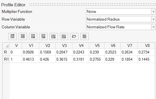

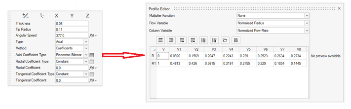

The same information is entered as input for the FAN_COMPONENT parameter as shown below in Figure 2.
Figure 2. Fan component Array Editor
The first column (0,1) is the normalized radius and the first row (0.0926,…,0.2734) defines the normalized flow rate. The second row data (0.4613,…,0.1445) are for the axial coefficient.

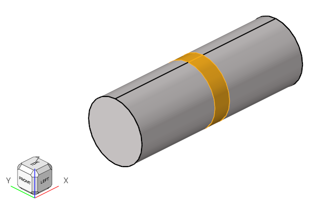

Define the Fan Component
  1. From the Flow ribbon, click the arrow next to the Domain tool set, and then select Fan Component.
    Figure 9.
  2. Select the middle solid as the fan component volume.

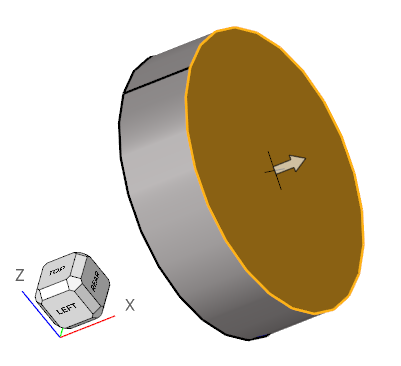

  3. On the guide bar, click Surfaces and then select the face shown below as the inlet of the fan component.
    Figure 11.
  4. From the View Controls toolbar, change the geometry visualization mode from Shaded Geometry to Transparent Geometry.
    This allows you to view the axis direction vector in the next step.
    Figure 12.
  5. On the guide bar, click Axis.
    In the modeling window, you can see that the axis points in the -X direction.
  6. Click in the microdialog to flip the axis vector to the +X direction.

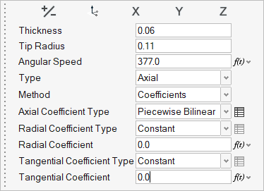

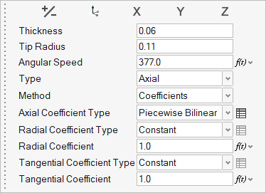

  7. Enter 0.06 for Thickness (m).
  8. Set the Type to Axial and set the Method to Coefficients.
  9. Enter 0.11 for Tip Radius (m) and 377 for Angular Speed (rad/sec).
  10. Set the Axial Coefficient Type to Piecewise Bilinear.
    Figure 14.
  11. Click beside Piecewise Bilinear to open the Profile Editor.
  12. Click , browse to the location where you saved FanAxialCoefficients.csv, and open it.
    Figure 15.
    Note: Both Normalized flow rate and Axial Coefficients have non-dimensionless units.
  13. Ensure that Row Variable is set to Normalized Radius and Column Variable to Normalized Flow Rate.
  14. Close the Profile Editor.
  15. Change the Radial Coefficient and Tangential Coefficient values from 1.0 to 0.0.
    Figure 16.
    Note: Make sure that both Radial and Tangential coefficient values are set to 0 since the fluid enters only in the axial direction.
  16. On the guide bar, click to execute the command and exit the tool.

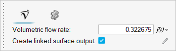

  1. From the Flow ribbon, Profiled tool group, click the Volumetric Flow Rate tool.
    Figure 17.
  2. Click the inlet face highlighted in the figure below.
    Figure 18.
  3. In the microdialog, enter 0.322675 for the volumetric flow rate (m3/sec).
    Figure 19.
  4. On the guide bar, click to execute the command and exit the tool.

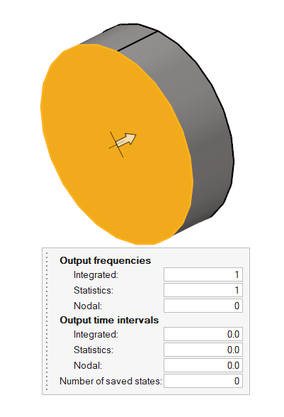

  4. From the Solution ribbon, click the Surfaces tool.
    Figure 27.
  5. Select the front face of the fan and verify that the arrow is heading toward the fan component, as shown in the figure below.
    Figure 28.
  6. On the guide bar, click to execute the command and remain in the tool.
  7. In the legend, rename surface_output to FAN_inlet.

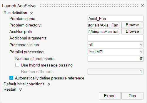

  10. From the Solution ribbon, click the Run tool.
    Figure 30.
    The Launch AcuSolve dialog opens.
  11. Set the Parallel processing option to Intel MPI.
  12. Optional: Set the number of processors to 4 or 8 based on availability.
  13. Leave the remaining options as default and click Run to launch AcuSolve.

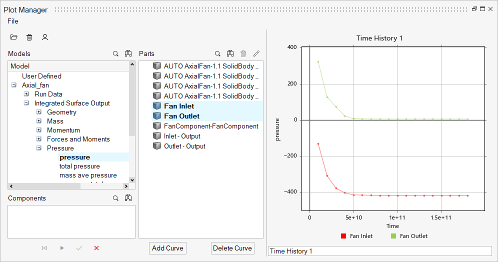

  2. Click to create a new plot.
  3. In the Data Tree, expand Integrated Surface Output > Pressure and then select pressure.
  4. Under Parts, select Fan_inlet and Fan_oultet to display pressure at the inlet and outlet.
    Figure 34.

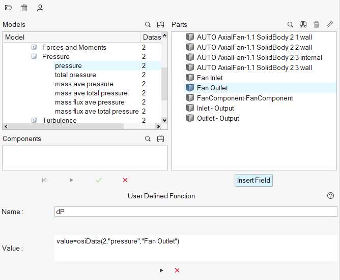

  5. Right-click User Defined under the Model panel to create a user defined function.
  6. In the Data Tree, expand Integrated Surface Output > Pressure and then select pressure.
  7. In the Name field, enter dP.
  8. In the Value field, type value=.

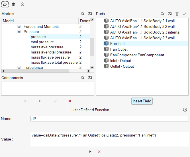

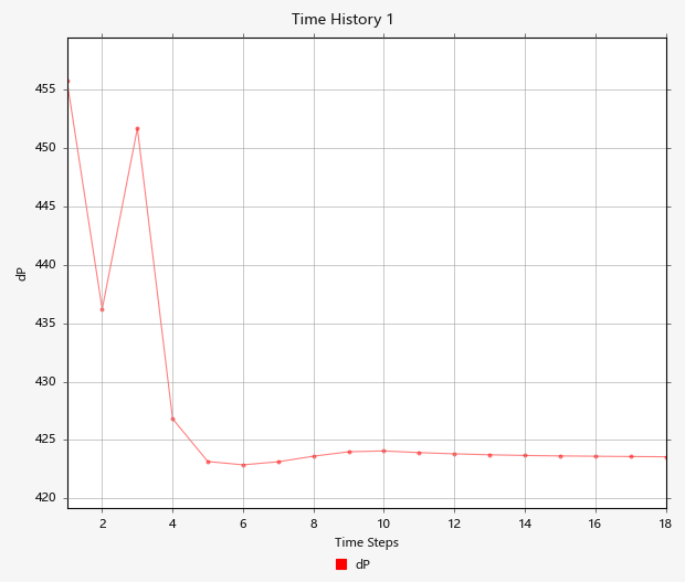

  9. Under Parts, choose FAN outlet then click to insert the field as part of the value, as shown below.
    Figure 35.
  10. Type - at the end of the user defined function value.
  11. Under Parts, choose FAN inlet and then click to insert the field as part of the value.
  12. Click to add the user-defined function.

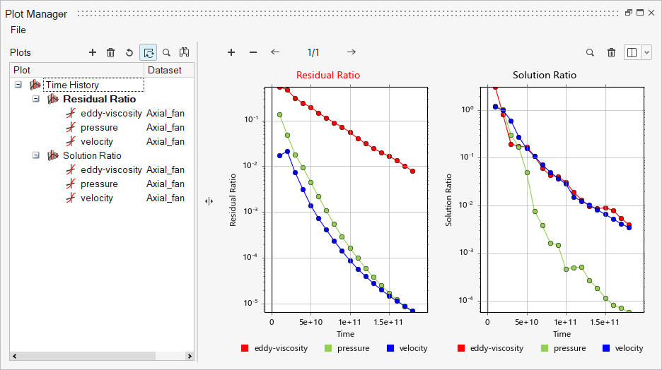

    Figure 36.
  13. Click the x axis to switch to Time Steps.
    Figure 37.
    From the above figure, the pressure got stabilized at around the 6th iteration and remains constant with pressure difference between the FAN_inlet and FAN_outlet of 423.97 Pa for a given volume flow rate 0.322675 m3/sec, which is very near compared to the reference pressure increase of 424.9 Pa.
