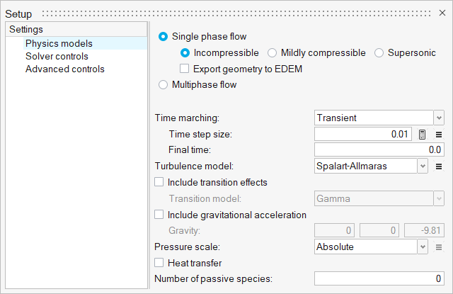

  2. Under the Physics models setting:
    1. Verify that the Incompressible option is selected under Single phase flow.
    2. Set the Time marching to Transient.
    3. Set the Time step size to 0.01 and the Final time to 0.0.
    4. Select Spalart-Allmaras as the Turbulence model.
    Figure 6.

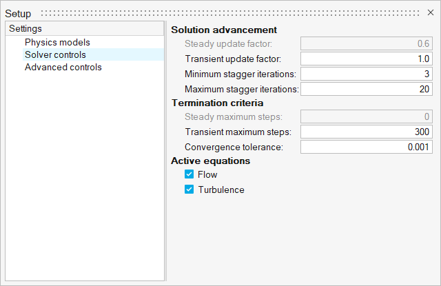

  3. Click the Solver controls setting.
    1. Set the Minimum stagger iterations to 3.
    2. Set the Maximum stagger iterations to 20.
    3. Set the Transient maximum steps to 300.
    Figure 7.

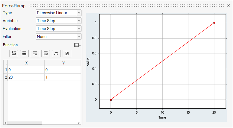

The force acting on the beam, due to the flow, will be ramped gradually over the first few time steps. After these first few time steps, the complete force from the fluid will be transferred to the beam without any ramping. This will be achieved using a Multiplier Function. In the next few steps you will create a linear multiplier function which will later be assigned as a force multiplier function for load acting on the beam.
  1. From the Flow ribbon, click the arrow next to the Setup tool set, then select Multipliers.
    Figure 8.
    The Multiplier Library opens.
  2. Click to add a new multiplier.
  3. In the multiplier creation dialog, change the name of the multiplier function to ForceRamp by clicking on the top-left corner.
  4. Set the Type to Piecewise Linear and the Variable to Time Step.
  5. Verify that the Evaluation is set to Time Step.
  6. Enter the table values according to the figure below.

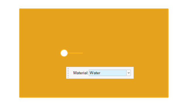

  2. Select the model body.
    The entire solid is highlighted.
  3. Select Water from the drop-down in the microdialog.
    Figure 11.
  4. On the guide bar, click to execute the command and exit the tool.

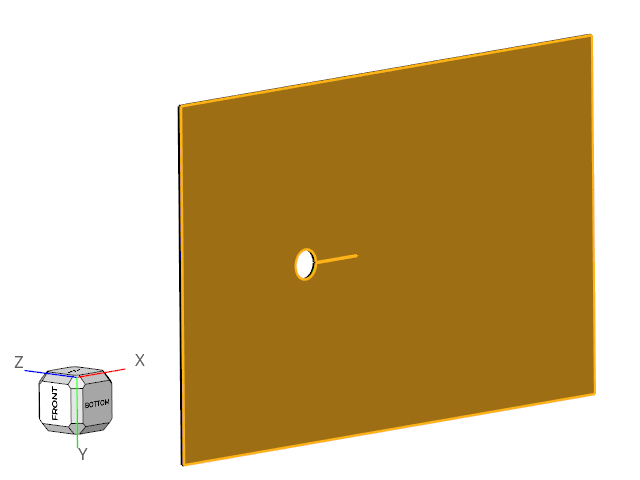

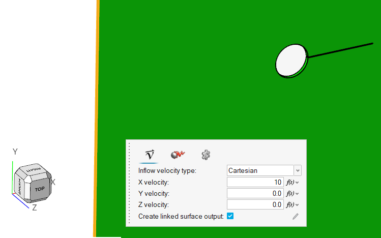

  2. Select the left-most face on the negative x-axis, as shown in the figure below.
  3. In the microdialog, choose Cartesian for the inflow velocity type and set X velocity to 10 m/s.
    Figure 13.

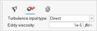

  4. Click the Turbulence tab in the microdialog. Choose Direct for the Turbulence input type and set Eddy viscosity to 1e-5 m2/sec.
    Figure 14.

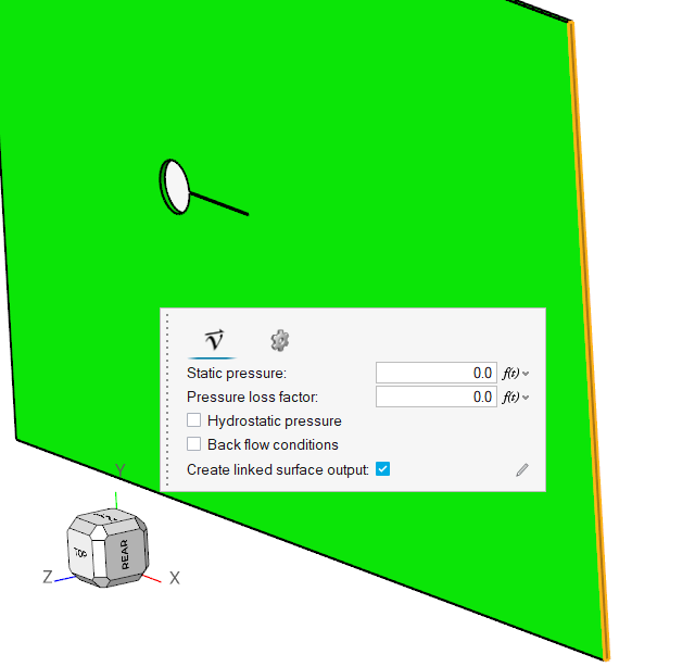

  6. Click the Outlet tool.
    Figure 15.
  7. Select the right-most face on the positive x-axis, as shown in the figure below.
  8. In the microdialog, verify that both the static pressure and the pressure loss factor are set to 0.
    Figure 16.
  9. Click on the guide bar.

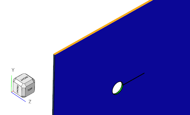

  11. Select the right-most face on the negative z-axis, as shown in the figure below.
    Figure 18.
  12. On the guide bar, click to execute the command and remain in the tool.
  13. In the Boundaries legend, double-click Slip, rename it to z_neg, and press Enter.
  14. Rotate the model and select the opposite face.
  15. Click on the guide bar.
  16. In the Boundaries legend, rename Slip to z_pos.
  17. Select the right-most face on the positive y-axis, as shown in the figure below.

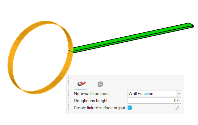

  24. Click the No Slip tool.
    Figure 20.
  25. Select the cylinder face, as shown in the figure below.
    Figure 21.
  26. Click on the guide bar.
  27. In the Boundaries legend, rename Wall to cylinder.

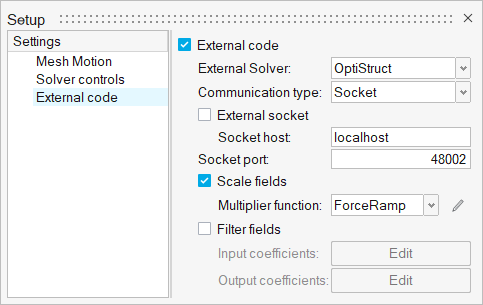

  4. Click the External code setting and activate the External code option.
  5. Set the External Solver to OptiStruct and the Communication type to Socket.
  6. Deactivate the External socket option and set the Socket host to localhost.
  7. Set the Socket port to 48002.
    The socket port depends on the structural solver. 48002 is the OptiStruct default and is thus used for this example. Refer to the manual of the structural solver you are using to determine the correct port number to be entered here.
  8. Activate Scale fields and select ForceRamp for Multiplier function.
    This will gradually ramp up the forces transmitted from the external code over the first few steps as specified by the multiplier function (20 time steps in this case).
    Figure 23.

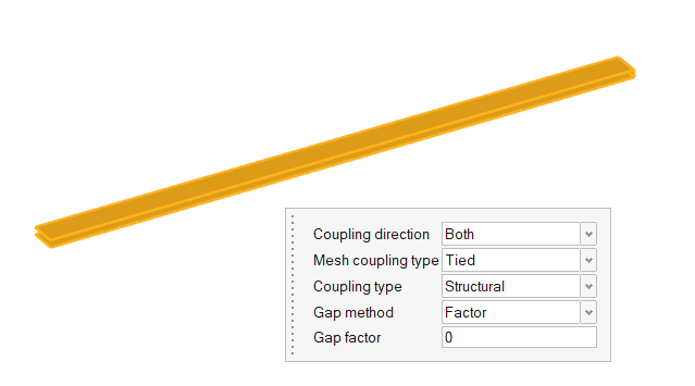

  2. Select the beam faces, as shown in the figure below.
  3. In the microdialog, select Factor for the Gap method and set Gap factor to 0.
    Figure 25.
  4. In the External Code Surface legend, rename the External surface to beam.

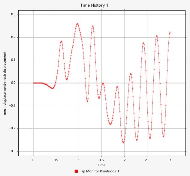

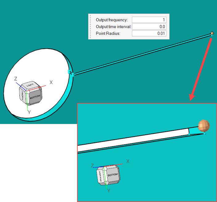

  1. Form the Solution ribbon, click the body of the Probe tool.
    Figure 29.
  2. Select the top point of the beam tip end on the right-most face of the negative z-axis, as shown in the figure below.
  3. In the microdialog, set the Point Radius to 0.01.
    Figure 30.
  4. In the Point Probes legend, rename Point Probe to Tip_Monitor_Point.

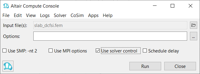

Run OptiStruct
  1. Start OptiStruct from the Windows Start menu by clicking Start > Altair <version> > Compute Console.
  2. Click next to Input file(s).
  3. Browse to the directory where you saved the OptiStruct model file.
  4. Select the slab_dcfsi.fem file.
  5. Activate Use solver control.
    Figure 33.
  6. Click Run to launch OptiStruct.

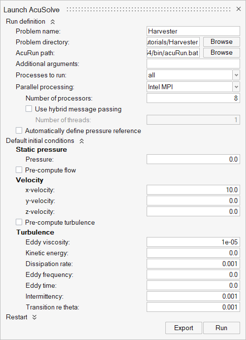

Run AcuSolve
  1. From the Solution ribbon, click the Run tool.
    Figure 34.
  2. Set the Parallel processing option to Intel MPI.
  3. Optional: Set the number of processors to 4 or 8 based on availability.
  4. Deactivate the Automatically define pressure reference option.
  5. Expand Default initial conditions and deactivate Pre-compute flow.
  6. Set the x velocity to 10 m/s.
  7. Set the eddy viscosity to 1e-05 m2/sec.
  8. Leave the remaining options as default and click Run to launch AcuSolve.
    Figure 35.
  9. Right-click the solver job in the Run Status dialog and select View log file.
    As the solution progresses, progress is reported in this window.
    When AcuSolve is started, it will listen to the socket port specified while setting up the external code coupling for an initial communication from OptiStruct. You must make sure to start the OptiStruct run which will initialize the socket port for communication. Once the connection is established, the solvers will alternatively send and receive data through the simulation steps.
Plot Time History
  1. Right-click the solver job in the Run Status dialog and select Plot time history.
  2. In the Plot Manager dialog, click to create a new plot.
  3. Expand Output Time History > Geometry and then select mesh displacement.
  4. Set Components to y.
  5. In the Parts field, choose node 1 under Tip Monitor Point to displace the time history of the beam end.
    Figure 36.
    Figure 37. Mesh_y_displacement plot at beam tip
    The plot above shows the displacement of the tip of the beam due to the fluid forces as the beam interacts with the flow.

  4. Click the Bottom face on the View Cube to align the model.
    Figure 38.

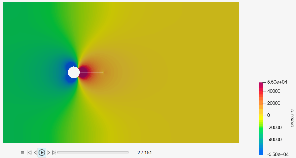

  5. Right-click the z_pos boundary in the Post Browser and select Isolate.
  6. Move the slide bar at the bottom of the modeling window to 74/151.
    Figure 39.
  7. Right-click z_pos again and select Edit.

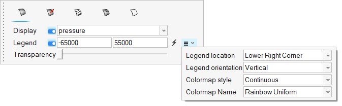

  8. In the display properties microdialog, set the display to pressure.
  9. Activate the Legend toggle and set the upper and lower bounds to -65000 Pa and 55000 Pa, respectively.
  10. Click and set the Colormap Name to Rainbow Uniform.
    Figure 40.
  11. Click on the guide bar.
  12. Click on the Animation toolbar to view a live animation of the flow.
