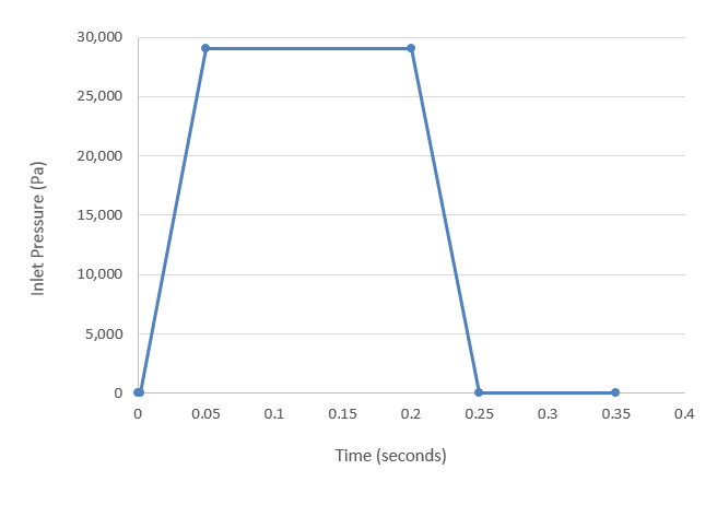

The initial inlet pressure is 0 Pa. At 0.002 s the pressure begins to ramp up and reaches 29,000 Pa at 0.05 s. The pressure is held at 29,000 Pa and begins to ramp back down starting at 0.2 s, reaching the initial pressure at 0.25 s where it remains for the rest of the simulation.
Figure 2. Transient pressure at the inlet

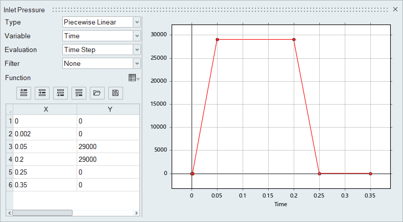

Create a Multiplier Function for the Inlet Pressure
  1. From the Flow ribbon, click the arrow next to the Setup tool set, and then select Multipliers.
    Figure 11.
  2. Click in the Multiplier Library dialog.
  3. In the multiplier creation dialog, change the name of the multiplier function to Inlet Pressure by clicking the top-left corner.
  4. Set the Type to Piecewise Linear.
  5. Verify that the Variable is set to Time and Evaluation is set to Time Step.
  6. Click four times to add four rows to the bottom of the table.
  7. Enter the table values according to the image below.
    Figure 12.

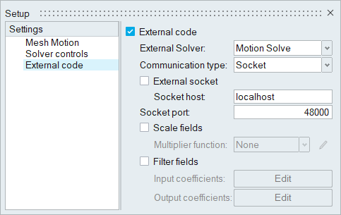

  3. Click the External code setting and activate the External code option.
  4. Set the External Solver to MotionSolve and the Communication type to Socket.
  5. Deactivate the External socket option and set the Socket host to localhost.
  6. Set the Socket port to 48000.
    Figure 25.

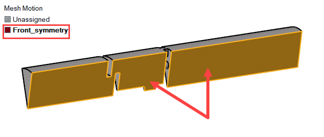

  1. From the Motion ribbon, click the Planar Slip tool.
    Figure 26.
  2. Select the two front symmetry surfaces shown Figure 27.
  3. In the Mesh Motion legend, rename Planar Slip to Front_symmetry by double-clicking the name.
    Figure 27.
  4. On the guide bar, click to execute the command and remain in the tool.
  5. Rotate the model and select the two back symmetry faces.
  6. In the Mesh Motion legend, rename Planar Slip to Back_symmetry.
  7. On the guide bar, click to execute the command and exit the tool.

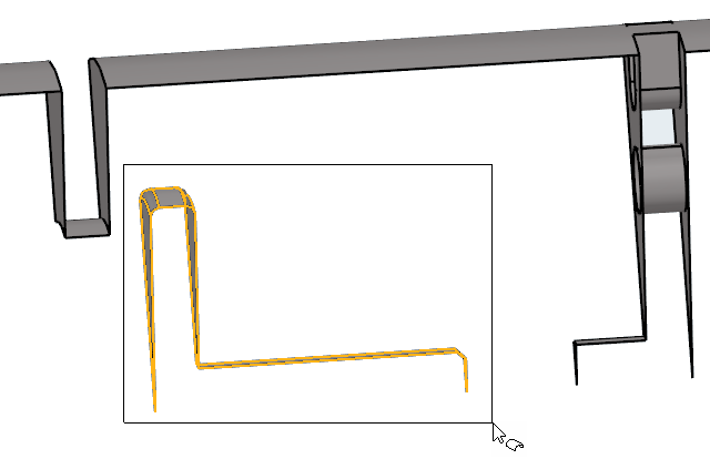

  11. Now that all the wall surfaces are highlighted, isolate the selected surfaces either by pressing the I key, or by right-clicking in the modeling window and selecting Isolate.
  12. Zoom in on the valve region and select all the valve wall surfaces using the window selection method.
    Figure 29.

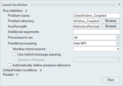

  1. From the Solution ribbon, click the Run tool.
    Figure 48.
  2. Set the Parallel processing option to Intel MPI.
  3. Optional: Set the number of processors to 4 or 8 based on availability.
  4. Deactivate the Automatically define pressure reference option.
  5. Leave the remaining options as default and click Run to launch AcuSolve.
    Figure 49.
    The Run Status dialog opens. Once the run is complete, the status is updated and you can close the dialog.

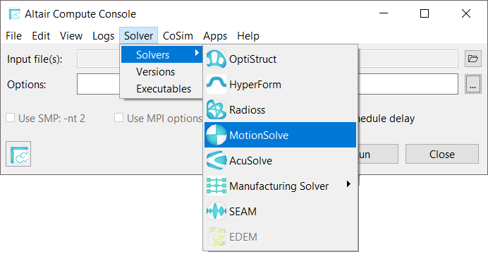

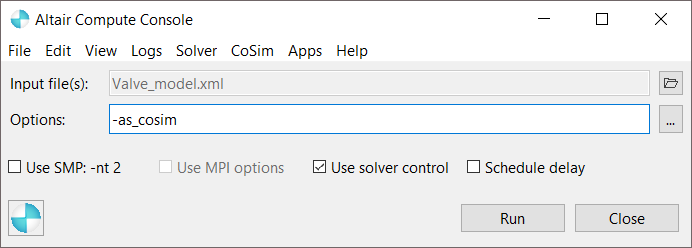

Run MotionSolve
  1. Run Start > All Programs > Altair <version> > Compute Console.
  2. From the menu bar select Solver > MotionSolve.
    Figure 50.
  3. Click besides the Input file(s) field, browse to the location where you saved Valve_model.xml, and open it.
  4. For Options, type -as_cosim to indicate coupling between MotionSolve and HyperMesh CFD.
    Figure 51.
  5. Click Run to start MotionSolve.

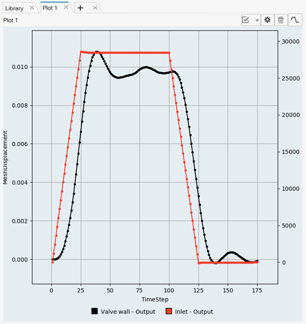

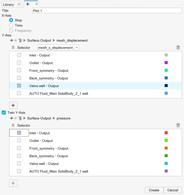

  1. From the Solution ribbon, click the Plot tool.
    Figure 52.
  2. Click next to the Library tab.
  3. Keep the X-axis set to Step. For the Y-axis, click the tree browser and select mesh_displacement under Surface Output.
    mesh_x_displacement is selected by default for the coordinate direction.
  4. Check the box for Valve wall - Output under Selector.
  5. Check the box for Twin Y-Axis.
  6. Click the tree browser for the second Y-axis and select pressure under Surface Output.
  7. Check the box for Inlet - Output under Selector.
    Figure 53.
  8. Click Create.
    Figure 54.
    Note: The valve motion lags behind the pressure changes at the inlet. Note also the spike around the 37th time step. This represents the collision of the valve stem with the stop and the subsequent rebound of the valve.

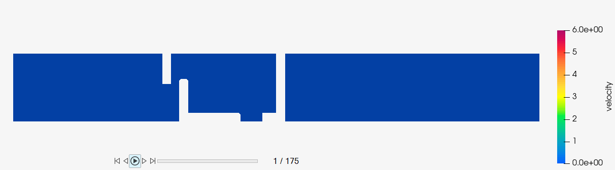

    Figure 56.
  10. Click on the guide bar.
  11. Click at the bottom of the modeling window to view a live animation of the flow.
    Figure 57.

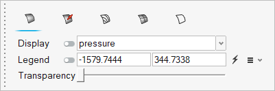

  5. Click in the slice plane microdialog.
  6. Turn off the Display in the Contour tab of the display properties microdialog.
    Figure 60.

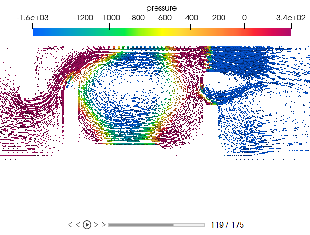

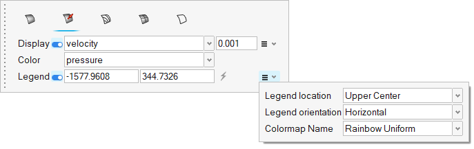

  7. Click the Vector Display tab.
  8. Turn the Display on, set the variable to velocity, and the value to 0.001.
  9. Set the Coloring to pressure.
  10. Activate the Legend toggle and click to reset the range.
  11. Click , set the Legend location to Upper Center, the Legend orientation to Horizontal, and the Colormap Name to Rainbow Uniform.
    Figure 61.
