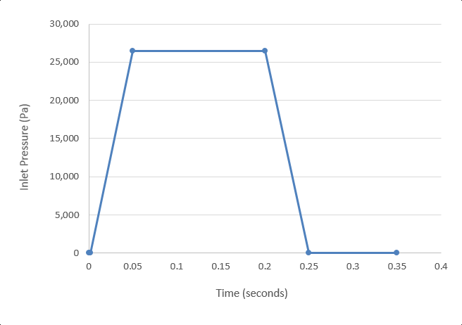

At the start of the simulation the flow field is stationary. Flow is driven by the pressure at the inlet, which varies over time as a piecewise linear function shown in Figure 2. As the pressure at the inlet rises, the flow will accelerate as the valve opens. The turbulence viscosity ratio is assumed to be 10.
The initial inlet pressure is 0 Pa. At 0.002 s, the pressure begins to ramp up, and reaches 26,500 Pa at 0.05 s. The pressure is held at 26,500 Pa and begins to ramp back down starting at 0.2 s, reaching the initial pressure at 0.25 s where it remains for the rest of the simulation.
Figure 2. Transient Pressure at the Inlet

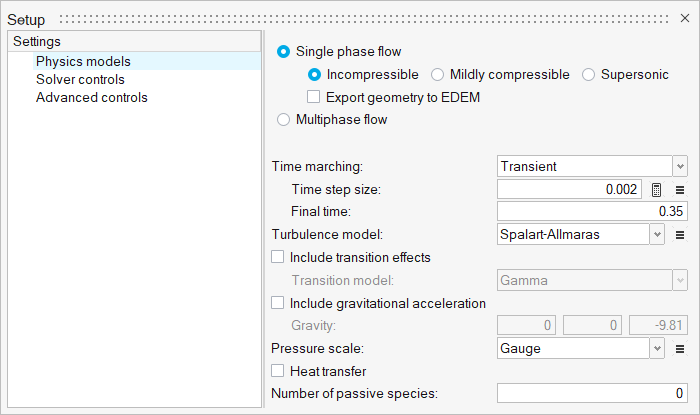

  2. Under the Physics models setting:
    1. Set Time marching to Transient.
    2. Set the Time step size to 0.002 and the Final time to 0.35.
    3. Select Spalart-Allmaras as the Turbulence model.
    Figure 9.

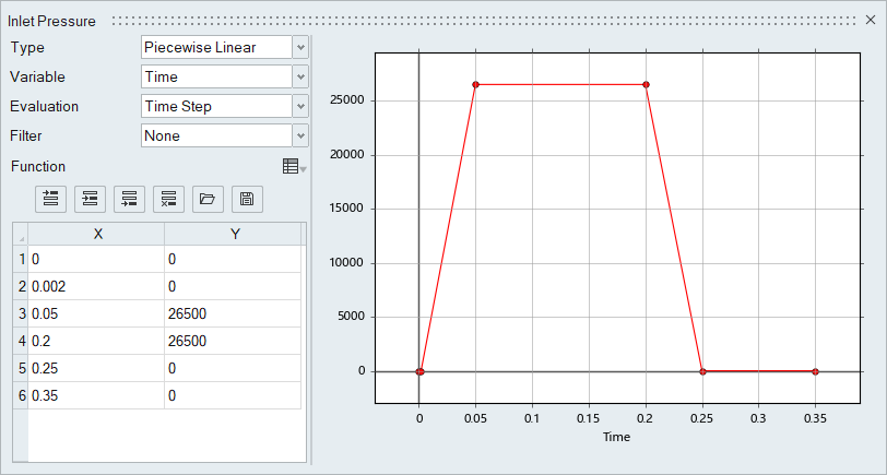

Create a Multiplier Function for the Inlet Pressure
  1. From the Flow ribbon, click the arrow next to the Setup tool set, and then select Multipliers.
    Figure 11.
  2. Click in the Multiplier Library dialog.
  3. In the multiplier creation dialog, change the name of the multiplier function to Inlet Pressure by clicking on the top-left corner.
  4. Set the Type to Piecewise Linear.
  5. Verify that the Variable is set to Time and Evaluation is set to Time Step.
  6. Click four times to add four rows to the bottom of the table.
  7. Enter the table values according to the image below.
    Figure 12.

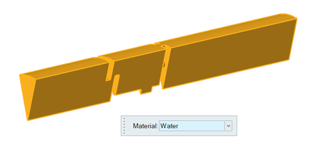

  1. From the Flow ribbon, click the Material tool.
    Figure 13.
  2. Click anywhere on the pipe geometry.
    The entire geometry is highlighted.
    Figure 14.
  3. In the microdialog, select Water from the Material drop-down menu.
  4. On the guide bar, click to execute the command and exit the tool.
  5. Save the model.

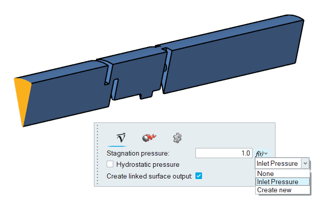

  2. In the modeling window, click the inlet surface, as shown in Figure 16.
  3. In the microdialog, enter a value of 1 N/m2 for the Stagnation pressure.
  4. Click the Multiplier function drop-down and select the function Inlet Pressure from the list.
    Figure 16.

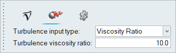

  5. Click the Turbulence icon on the microdialog, set the Turbulence input type to Viscosity Ratio, and then enter a value of 10 for the Turbulence viscosity ratio.
    Figure 17.
  6. On the guide bar, click to execute the command and remain in the tool.

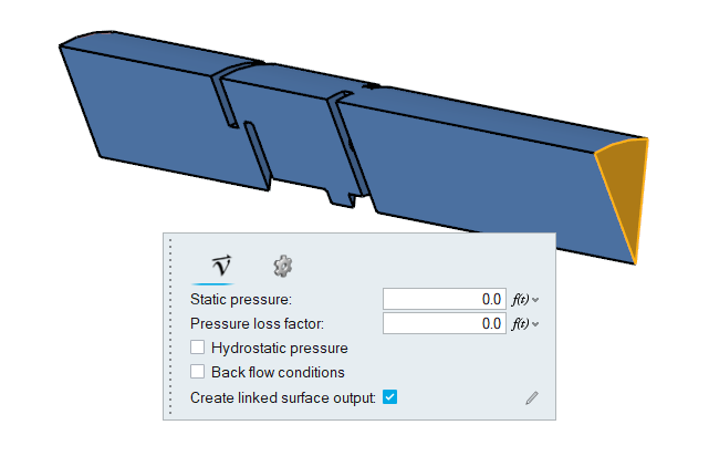

  8. Click the Outlet tool.
    Figure 18.
  9. Click the outlet surface shown in the figure below.
    Figure 19.
  10. On the guide bar, click to execute the command and exit the tool.

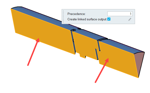

  11. Click the Symmetry tool.
    Figure 20.
  12. Select the two surfaces shown in the figure below.
    Figure 21.

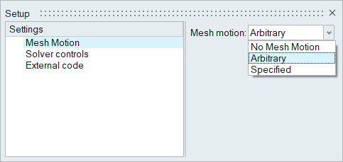

  2. In the Setup dialog, change the Mesh motion to Arbitrary.
    Figure 24.

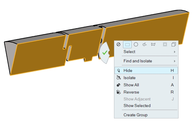

  3. For convenience, hide the Front_symmetry and Back_symmetry faces in the modeling window by selecting the four surfaces and then pressing H on the keyboard or by right-clicking and selecting Hide from the context menu.
    Figure 26.

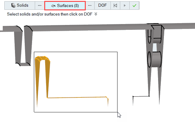

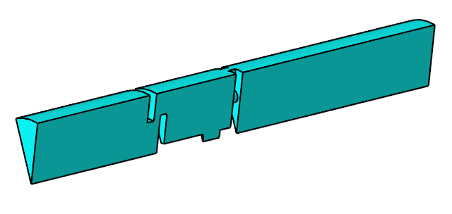

  4. Select the valve wall surfaces, shown in the figure below, by using box selection (hold and drag the left mouse button).
    The number of surfaces selected should be 8, which will show on the guide bar.
    Figure 27.

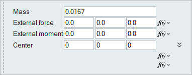

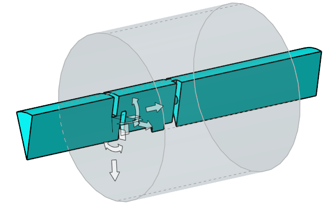

  5. On the guide bar, click DOF and then click anywhere on the valve wall surfaces in the modeling window.
  6. In the microdialog that appears, enter the following values:
    • Mass: 0.0167 kg
    • Center: (0, 0, 0)
    Figure 28.

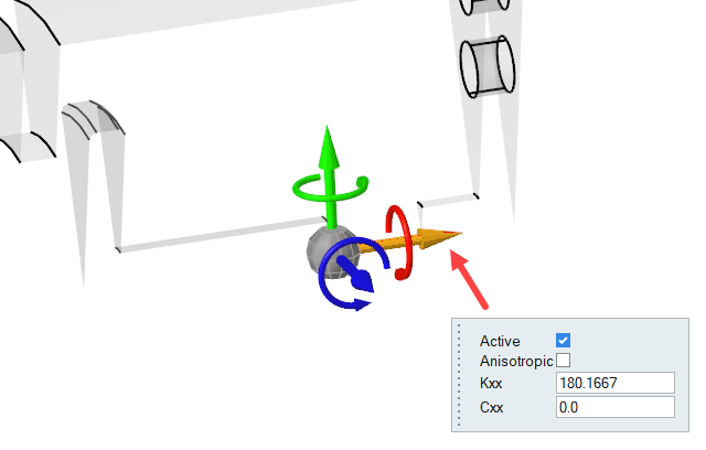

  7. Click the X-displacement arrow in the modeling window.
  8. In the microdialog, enter a value of 180.1667 kg/sec2 for Kxx, the stiffness of the spring.
    Figure 29.

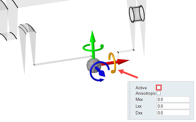

  9. Click the X-rotation arrow and deactivate it.
    Figure 30.
  10. Similarly, click the remaining four arrows (Y-displacement, Y-rotation, Z-displacement, and Z-rotation) and deactivate them.
    This will ensure that the valve body translates only in the x-direction.

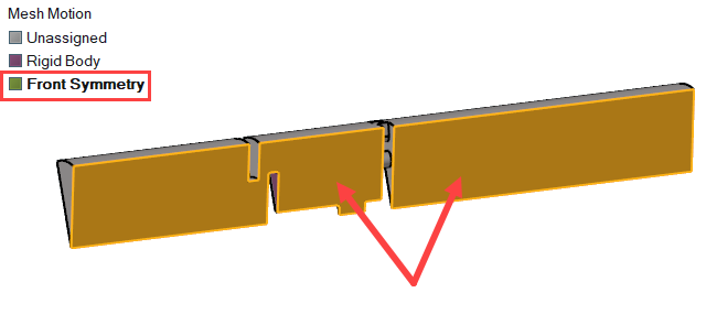

  1. From the Motion ribbon, click the Planar Slip tool.
    Figure 31.

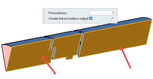

  2. Select the two front symmetry surfaces shown in Figure 32.
  3. In the Mesh Motion legend, rename Planar Slip to Front_symmetry by double-clicking the name.
    Figure 32.
  4. On the guide bar, click to execute the command and remain in the tool.
  5. Rotate the model and select the two back symmetry faces.
  6. In the Mesh Motion legend, rename Planar Slip to Back_symmetry.

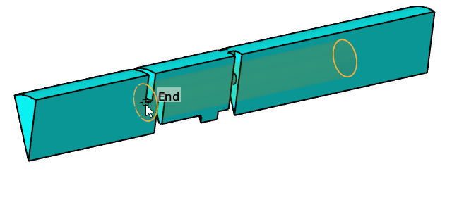

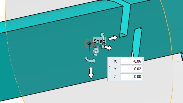

  2. In the modeling window, hover the mouse around the point shown in the figure below. When the preview cylinder zone is parallel to the axis of the pipe, click the model near the point shown below.
    This point will be the center of the front face of the cylinder. In the next few steps you will edit the coordinates of this point manually.
    Figure 34.
  3. Move the mouse cursor away from the center and then click again.
    A preview of the zone should be displayed on the screen along with the manipulator. The manipulator allows you to modify the location and orientation of the zone.
    Figure 35.
  4. Click the center of the manipulator and enter the following coordinates for the center (-0.06, 0.02, 0).

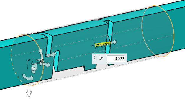

  5. Double-click the cylindrical surface of the zone and enter 0.022 m as the radius of the cylinder.
    Figure 37.

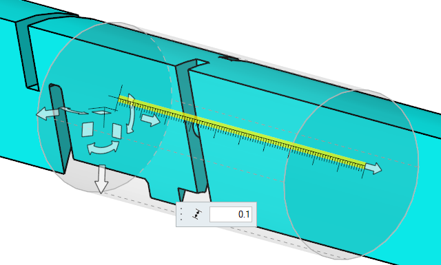

  6. Double-click the base of the cylinder and enter 0.1 m as the height of the cylinder.
    Figure 38.

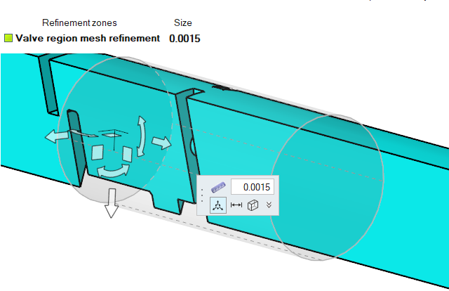

  7. Click anywhere in the empty space in the modeling window.
  8. Enter a value of 0.0015 m for the mesh size in the microdialog.
  9. In the Refinement zones legend, rename the zone to Valve region mesh refinement.
    Figure 39.

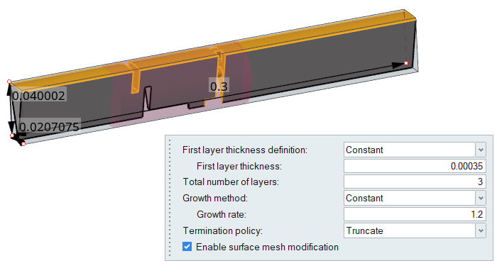

  1. From the Mesh ribbon, click the Boundary Layer tool.
    Figure 40.
  2. Right-click in the modeling window and go to Select > Advanced Select > By Boundaries > Default Wall.
    All the wall surfaces should be highlighted and a dialog for BL specification appears.
  3. Enter the following values in the dialog:
    1. First layer thickness: 0.00035
    2. Total number of layers: 3
    3. Growth method: Constant
    4. Initial growth rate: 1.2
    5. Termination policy: Truncate
    6. Activate Enable surface mesh modification.
    Figure 41.
  4. In the BL Controls legend, rename the BL control to Pipe walls BL.
  5. On the guide bar, click to execute the command and remain in the tool.

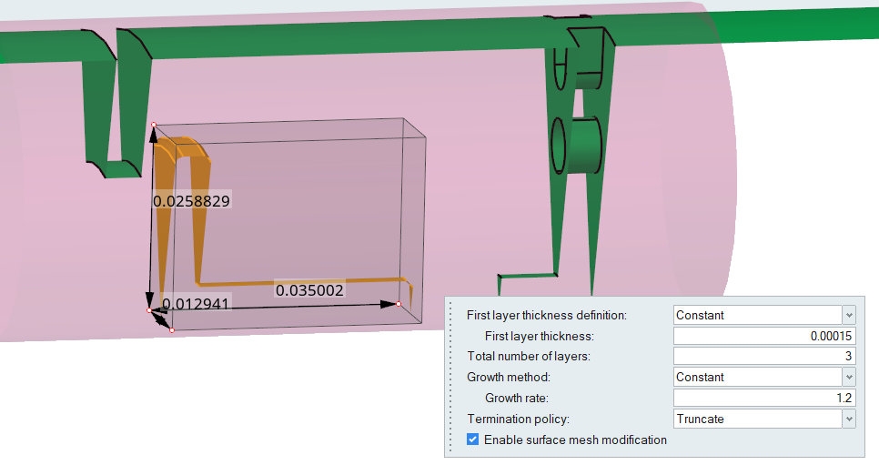

  6. In the next few steps, you will define the boundary layer mesh control for the valve walls. For convenience, hide the front and back symmetry faces.
  7. Select the valve wall surfaces using the box selection method.
  8. In the dialog that appears, enter the following values for the BL specification:
    1. First layer thickness: 0.00015
    Figure 42.
  9. In the BL Controls legend, rename the BL control to Valve walls BL.
  11. Click the drop-down next to the Mesh Controls tool set and select Advanced.
    Figure 43.

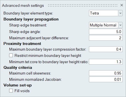

  12. In the Advanced mesh settings dialog, change the Boundary layer element type to Tetra and then close the dialog.
    Figure 44.

Generate the Mesh

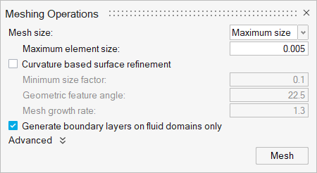

  1. From the Mesh ribbon, click the Volume tool.
    Figure 45.
  2. In the Meshing Operations dialog, set the Mesh size option to Maximum size and set the Maximum element size to 0.005.
  3. Deactivate Curvature based surface refinement.
  4. Click Mesh to generate the mesh.
    Figure 46.
    Once the meshing process has started, the Run Status dialog appears and the application moves to the Solution ribbon.
  5. Once the meshing is completed, close the Run Status dialog.

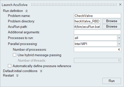

  1. From the Solution ribbon, click the Run tool.
    Figure 49.
  2. Set the Parallel processing option to Intel MPI.
  3. Optional: Set the number of processors to 4 or 8 based on availability.
  4. Deactivate the Automatically define pressure reference option.
  5. Leave the remaining options as default and click Run to launch AcuSolve.
    Figure 50.

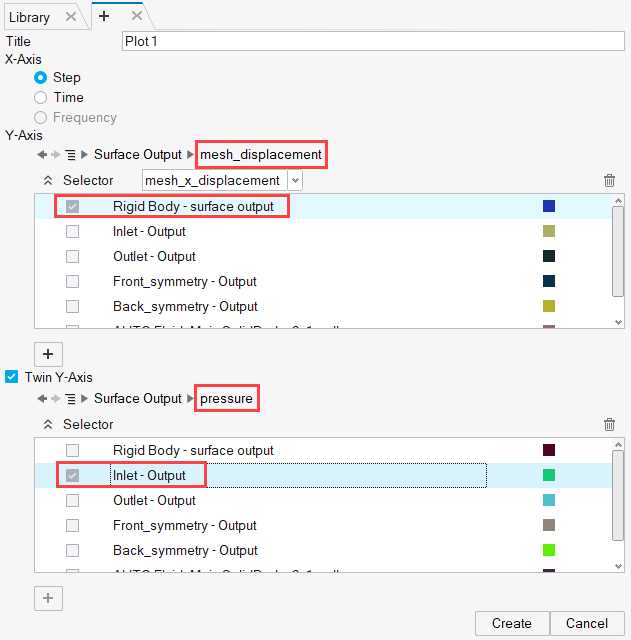

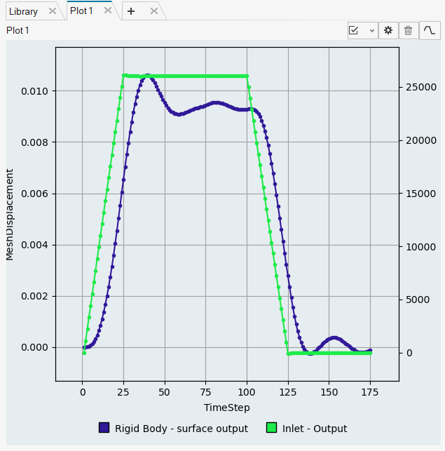

Monitor Results
  1. From the Solution ribbon, click the Plot tool.
    Figure 51.
  2. Click next to the Library tab.
  3. Keep the X-axis set to Step. For the Y-axis, click the tree browser and select mesh_displacement under Surface Output.
    mesh_x_displacement is selected by default for the coordinate direction.
  4. Check the box for Rigid Body - surface output under Selector.
  5. Check the box for Twin Y-Axis.
  6. Click the tree browser for the second Y-axis and select pressure under Surface Output.
  7. Check the box for Inlet - Output under Selector.
    Figure 52.
  8. Click Create.
    Figure 53.

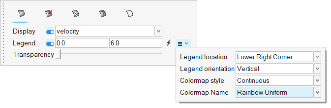

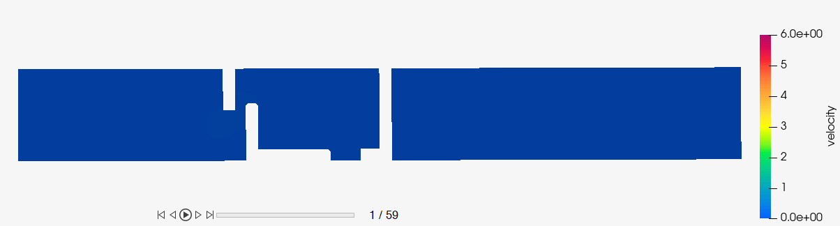

  7. In the display properties microdialog, set the display to velocity.
  8. Activate the Legend toggle and set the max velocity to 6.0.
  9. Click and set the Colormap Name to Rainbow Uniform.
    Figure 55.
  10. Click on the guide bar.
  11. Click at the bottom of the modeling window to view a live animation of the flow.

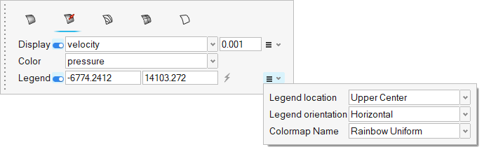

  7. Click the Vector Display tab.

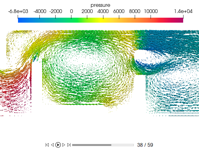

  8. Turn the Display on, set the variable to velocity, and the value to 0.001.
  9. Set the Coloring to pressure.
  10. Activate the Legend toggle and click to reset the range.
  11. Click , set the Legend location to Upper Center, the Legend orientation to Horizontal, and the Colormap Name to Rainbow Uniform.
    Figure 60.
  12. Click on the guide bar.
  13. In the Post Browser, right-click Slice Plane 1 and select Isolate.
    Figure 61.
