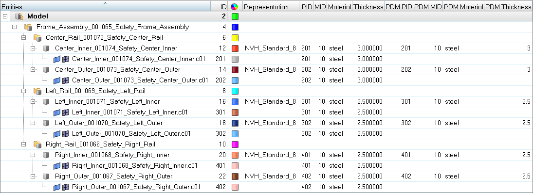

All BOM-related information, including part/assembly hierarchy, part attributes, and representation information is organized and displayed in the Part Browser.
Representation (HyperMesh session) attributes are now displayed independent of the PDM attributes. Attribute columns can be turned on/off in the Column Visibility dialog, which can be accessed by right-clicking in the Part Browser and selecting Column Visibility from the context menu.

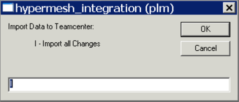

Update Teamcenter
Update Teamcenter via Teamcenter-HyperMesh Integration
If HyperMesh was launched via the Teamcenter - HyperMesh Integration, you will be prompted to import updated data back to Teamcenter.

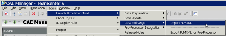

Update Teamcenter via Manual PLMXML Import in Teamcenter
If the BOM was loaded manually, for example HyperMesh was not launched via the Teamcenter-HyperMesh Integration, then the updated PLMXML package can be manually imported into Teamcenter.
  1. Copy the exported BOM PLMXML, along with the folder(s) containing the monolithic file, if saved, and any saved/updated representations to a convenient folder accessible by Teamcenter.
  2. Select Import PLMXML to import the updates.

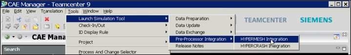

Directly launch HyperMesh and import the selected BOM.
The selected BOM and associated files will be exported from Teamcenter and automatically loaded in the HyperMesh Part Browser, which replaces the Assembly Browser used in previous versions.

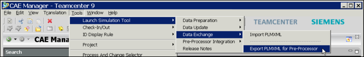

  2. Export the PLMXML package so that you can work on it over time by selecting the Export PLMXML for Pre-Processor option.
    Figure 5.
  3. The resulting PLMXML BOM file, along with its associated data files, will be exported to the last data folder and can be imported directly into HyperMesh via File > Import > BOM.

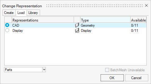

Load Representations from Current HyperMesh Session
  1. In the Part Browser, right-click on part assemblies or parts and select Representations > Load > from Session from the context menu.
  2. In the Change Representation dialog, Load tab, select a type of representation to load.
    Representations that exist in the repository are shown in the Representations column, and their availability is indicated in the Available column.
    Figure 6.
  3. To send unavailable representations to the BatchMesher directly from the Change Representation dialog, select Batch Mesh Unavailable.
    Note: Available representations will also be loaded when you click OK if Batch Mesh Unavailable is selected.
  4. To save the representations to the Part Library, select the Save to Library checkbox.
  5. Click OK.
  6. In the Confirm Load Representation dialog, specify how representations are loaded.
    • Click Load All to load all available representations into the current session for selected parts.
    • Click Skip Loaded to ignore representations that are already loaded for selected parts.
As representations are created and saved to the repository they are displayed in the Available Representations pane.

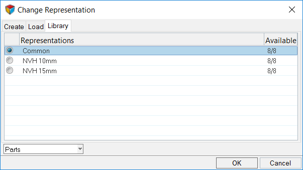

Load Representations from the Part Library
After importing a BOM that has representations saved in the Part library, you can load the saved representations.
  1. In the Part Browser, right-click on a part/part assembly and select Representations > Load > from Library from the context menu.
  2. In the Change Representation dialog, Library tab, select representations and click OK.
The selected representations are loaded to the Representation folder on the file system. Similarly, every time a BOM is imported, files are loaded to the Representations folder, if you retrieve them from the Part Library.
Figure 7.

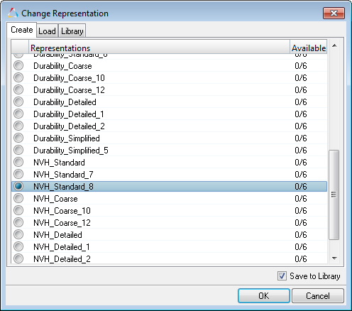

Create Mesh Representations
  1. In the Part Browser, right-click and select Representation > Create from the context menu.

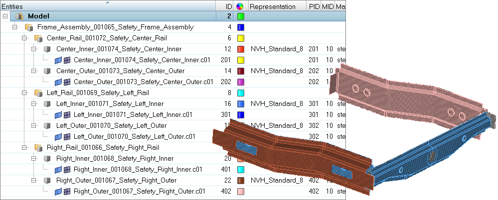

  2. In the Change Representation dialog, Create tab, select the NVH_Standard_8 representation.
    Each representation is uniquely identified by its alias and file type. For example, “NVH_Standard_8/HyperMesh” and “NVH_Standard_8/Nastran” representations.
    The appropriate representation will automatically be selected, based on the available PLMXML metadata: discipline, mesh representation, and mesh density. If the appropriate metadata is unavailable, then you can select the desired representation type to create. In the Change Representation dialog, Create tab, only HyperMesh representations can be created.
    Per the current Teamcenter-HyperMesh integration rules, only one representation per file type is allowed per part. This means that you can only have a single HyperMesh file type representation, Nastran file type representation, CAD representation, and so on for each part. For example, if you create a NVH_Standard_8/HyperMesh representation and then subsequently create a NVH_Coarse_15/HyperMesh representation, the NVH_Coarse_15/HyperMesh representation will become the only HyperMesh representation for the given part.
    Figure 8.
  3. To save the newly created representations to the Part Library select the Save to Library checkbox.
  4. Click OK.
BatchMesher is invoked, and meshes are created using the appropriate batch meshing parameter and criteria files.
The parameter and criteria file mappings are configurable based on the batchmesher_config.cfg file available in the installation.
As part of the post-batchmeshing process, each part’s components are created, using the Teamcenter-HyperMesh naming convention. In addition, the loaded representation (NVH_Standard_8 in this case) is displayed, and the component ID (CID), property ID (PID), Material, and Thickness are created, per the values available in the PLMXML BOM.
