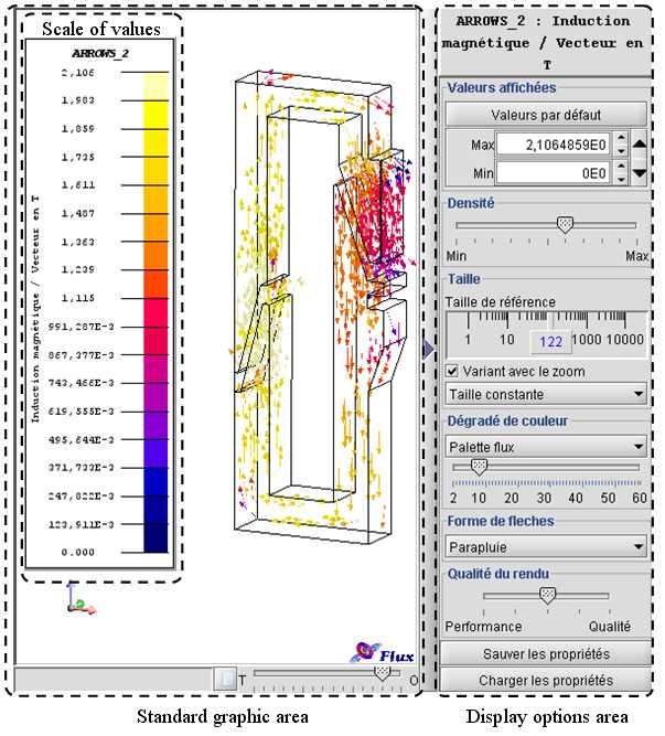

Environment
The computed arrows are displayed on the chosen support and visualized in the graphic standard zone with the following item added:
- a scale of values
- a display option zone (arrows: options)
Note: the environment is the same for the display of isovalues, isolines and arrows
| Zone | Function |
| Scale of values |
Area comprising the scale of values calculated and displayed with the correspondence of the color shade. This scale can be displaced in the standard area, enlarged or reduced. |
| Standard graphic area | Area comprising the geometric view of the device with the displaying of the calculated isovalues. |
| Display options area |
Area comprising the display options of the calculations of isovalues, isolines and arrows. Each type of calculation has an activable tab to permit to switch from the display options of the isovalues to the display options of the arrows. |
