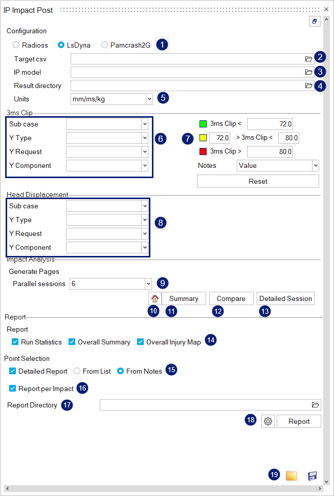

From the ribbon > tool group, select the Instrument Panel tool to invoke the IP Impact Post dialog.
- Configuration (Solver Selection)
Supported solvers are Radioss, LS-DYNA, and PAM-CRASH 2G.
- Target csvSelect the HyperMesh-created *.csv file.Note: Upon using HyperMesh to mark and position the impactor, HyperMesh generates a CSV file
- IP model
Select the solver input file that contains the Instrumental Panel model.
- Result directory
Select the root directory that contains the analysis directories as sub-directories.
- Units
Select the model units from the drop-down menu.

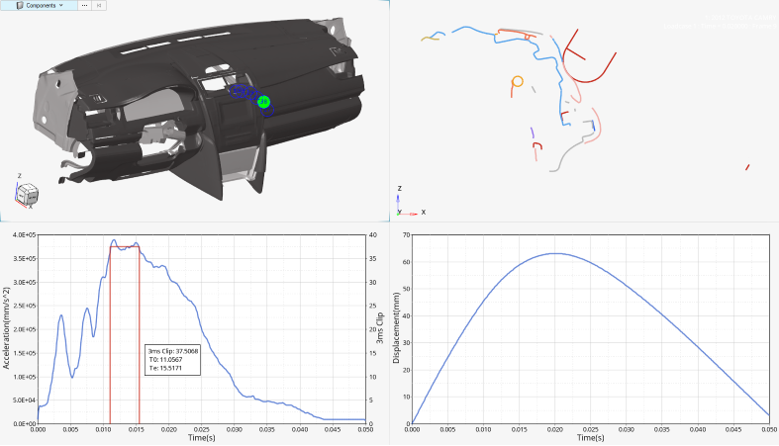

- 3ms Clip
Select the acceleration data from the output file for the 3ms clip curve.
Select the sub case, Y Type, Y Request, and Y Component.
- Threshold/Limit Values and Color SelectionDefine the limit values and colors.
- Click the color palette to select the color.
- Define the limit/threshold values in the value field.
- Select the 3ms clip value or the impact location name for summary.
- Use Reset to restore the default values and colors.
- Head Displacement
Select the displacement data from the output file for the displacement versus time curve.
- Parallel sessions
Select the number of batch processes to launch. For example, if processing 200 impact locations, the number of parallel processes are launched to reduce processing time.

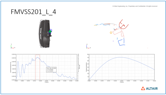

- Detailed SessionClick Detailed Session to select the impact locations to be processed through the Select target points window. For each selected target point, a page is generated with the following results:
Figure 4.

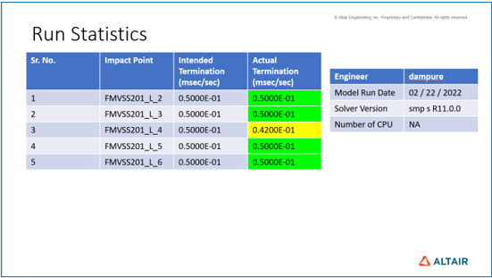

- ReportRun Statistics: Run a summary of the Normal versus Error termination per impact location:
Figure 5.

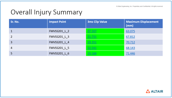

Overall Summary: Summary table of the 3ms clip value and maximum displacement for all selected impact locations.Figure 6.

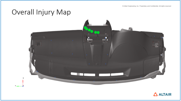

Overall Injury Map: 3ms map on the Instrumental Panel.Figure 7.

- Report per ImpactA detailed slide for all selected impact points is created in the report.
Figure 8.
