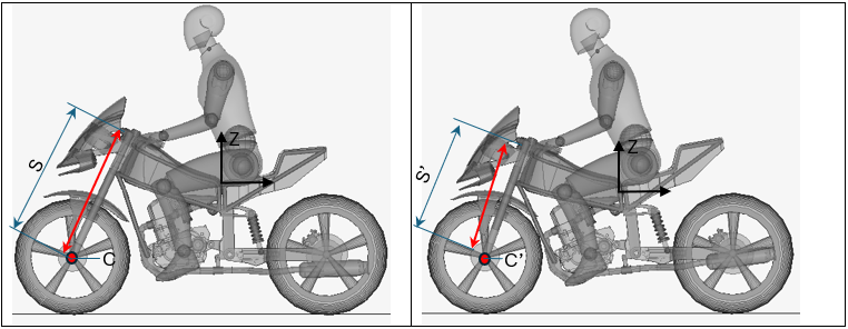

- Let the spring length be equal to S.
- And the wheel center position be C (Z coordinate in the vehicle body’s reference frame).
- Let the spring length be equal to S’.
- And the wheel center position be C’ (Z coordinate the vehicle body’s reference frame).
The motion ratio is calculated as: (S-S’) ÷ (C-C’).

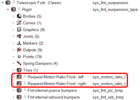

Motion Ratio Output Requests in Library Models
| SolverVariable | Purpose | Function |
| Motion ratio | Measure the motion ratio of the spring entity | USER(100, {m_frame_cm.idstring},
{m_wheel.idstring},
{spring.idstring}) Args: #1: Branch ID. Default = 100. #2: Reference frame ID for reporting wheel center displacement along Z. #3: ID of the marker on spindle body located at wheel center. #4: Spring entity ID. Motion ratio of this entity will be calculated. FUNCTION: MOTION_RATIO |
The value of this variable is used in the output request with label prefixed with Motion ratio - Request Motion Ratio.
