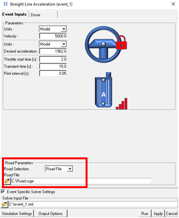

The .crge road works as the .crg in the AutoTire
panel and Event Editor.
- In the AutoTire panel, browse and select the .crge for the Road
Property File.
Or in the Event Editor dialog, select Road File under Road selection.Figure 3.

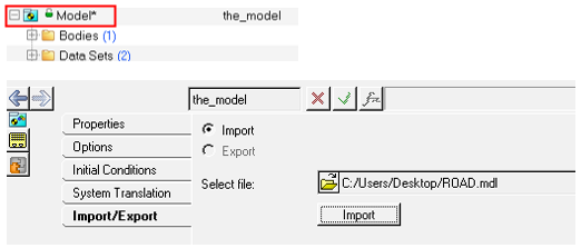

- Select the Model and import the .mdl of
the road package as a system using the Import/Export option.
Figure 4.

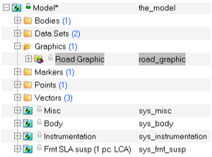

A Road Graphic System is created containing the .h3d with graphics information of the road.Figure 5.

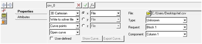

- To use the road centerline in a MotionView event, create a
3D Cartesian curve entity and select the .csv file within the
package.
Figure 6.

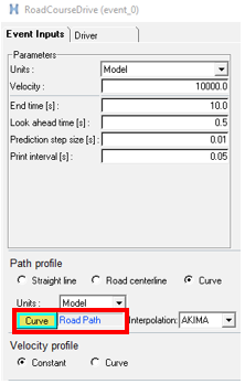

- In the RoadCourseDrive Event, select the created curve under the Path profile curve
option.
Figure 7.
