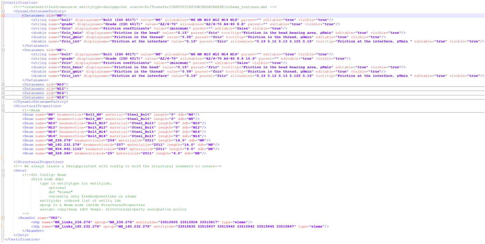

The *.xml file must contain the top-level
<Certification> tag.
Every entity to import must be defined between the
<Certification> and
</Certification>tags.

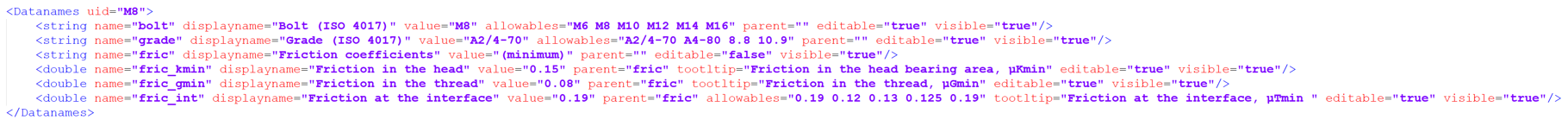

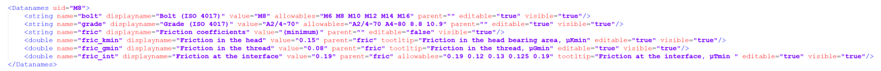

<DynamicDatanameFactory><StructuralProperties><Sets>
Contains a collection of tags <Dataname uid=””> where uid is
later referred to by the ddh=”” attribute inside structural
properties.

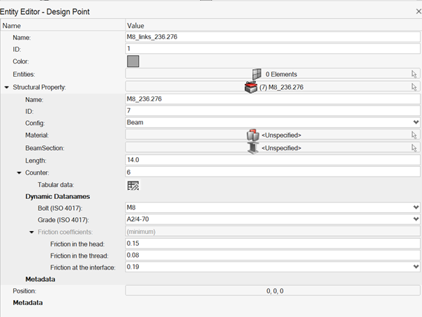

Such blocks aim to define a reusable list of dynamic data names to be added to a structural property. Below examples contain such an xml block as well as its counterpart in the HyperMesh GUI and how it renders in the Entity Editor.
- string : attributes of type string (support spaces)
- double: float attributes
- bool: Boolean attributes
This is rendered as a check box in the GUI
- int: integer
- uint: unsigned integer
- fileopen: file path rendered with a widget to open existing file
- filesave: file path rendered with a widget to save file to the disk
- diropen: directory path rendered with a widget to select a folder
name=”” is mandatory and is the actual data name used in query.
displaynameis the one displayed in the GUI- If
allowables=””is provided, then a combobox with prescribed choice will render the selection value=””is the default value given to the attributesparent=””allows to have hierarchical display of attributes in the GUIeditable (resp. visible)controls if the attribute is editable (resp.if the attribute must be hidden)

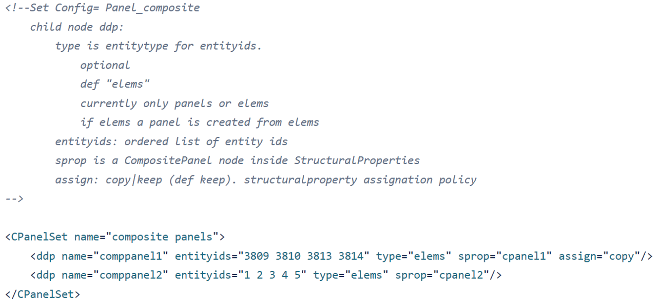

Sets
designpointsets) to define some designpoints.
The config of designpointsets are contained in their type:RivetSet: designpointset of config=rivetBeamSet: designpointset of config=beamMPanelSet: designpointset of config= panel _metallicCPanelSet: designpointset of config= panel _compositeGenericSet: designpointset of config=generic
<ddp name=”” type=”” entityids=”” sprop=”” assign=””/>nameis unique name of designpointentityidsis an ordered list of entity of type defined bytype=””(default elems)- For cpanel and mpanel, a panel entity is created out of the selected elements.
Spropmust be equal to the name of a structural property of same configurationassign=”copy|keep”controls if structuralproperty is directly assigned (keep) or if a copy is created first
