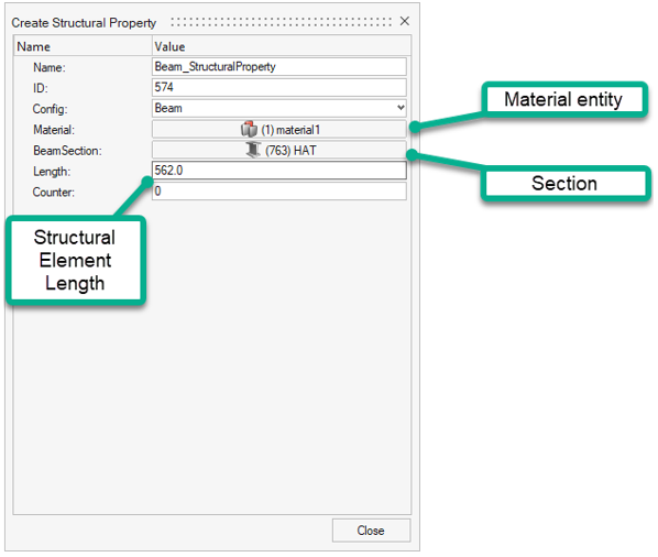

Configuration Description Beam Beam structural properties refer to a Material entity and a Beamsection entity. They also have a Length data name which represents the physical length of the Member (column) that needs to be considered in methods (that length is multiplied by the constraint factor in buckling length calculation). When a structural property is created from Beam structural element detection, the length defaults to the total length of the beam elements absorbed.Figure 2.

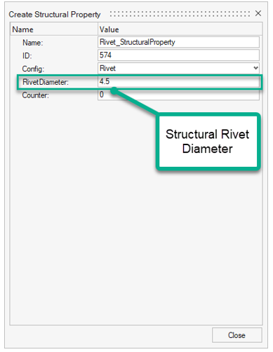

Rivet Rivet structural properties contain, by default, the Rivet diameter. This diameter is considered in the size of the extraction area where far field fluxes are extracted.Figure 3.

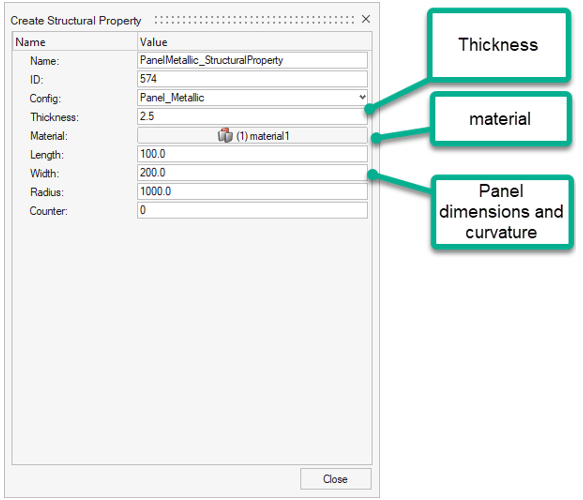

Panel Metallic Panel metallic structural properties contain reference to:- Panel thickness (constant for the whole panel)
- Metallic material
- Panel dimensions (width/length/radius of curvature)
Figure 4.

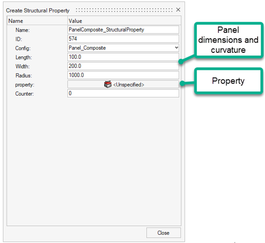

Panel Composite Panel composite structural properties contain reference to:- Panel dimensions (width/length/Radius of curvature)
- Composite property
For the OptiStruct/Nastran solver profiles, the property used is of type PCOMP/PCOMPG. The sequence information (ply thicknesses, orientations, and materials) are extracted from this property.
A structural property assigned without reference to a property runs using a direct elemental property instead of a “panel-level” property.Figure 5.

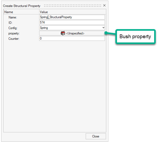

Spring Spring structural properties contain reference to:- Bush property
For the OptiStruct/Nastran solver profiles, the property used is of type PBUSH.Figure 6.

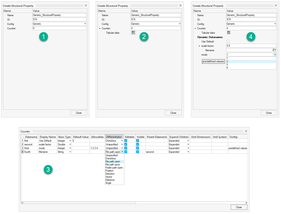

Add Data Names
Specify the number of data names to add in the Counter field.
A Tabular data entry becomes available.
- Click the table icon.
Use the new dialog to fulfill the details of data names to be added.
The following are descriptions of the attribute columns and behaviors in the table editor, see Figure 8:
- Dataname
- The actual internal name of the added data name saved in the binary file.
- Display Name
- The label displayed in the Entity Editor.
- Basic Type
- Defines the type of the data name.
- Default Value
- Defines the default value displayed in the user interface.
- Allowables
- Provides a list of allowable entries.
- Differentiator
- Defines a special rendering of the data name in the user interface. It defaults to Unspecified. Other options are:
- Editable
- Controls whether you can change value in the user interface.
- Visible
- Controls whether the data names is shown in the user interface.
- Parent Dataname
- If a previously defined data name is set (by its Dataname field) in this cell, the currently defined data name becomes a child of the above-mentioned Parent Dataname. Parent data names are rendered as a group that can be expanded/collapsed.
- Expand Children
- Controls the way children data names are expanded. Valid values are:
- Tooltip
- Shows the tooltip when the mouse hovers over the display name.
The other column headers available in the table editor are reserved for future use.Figure 8.
