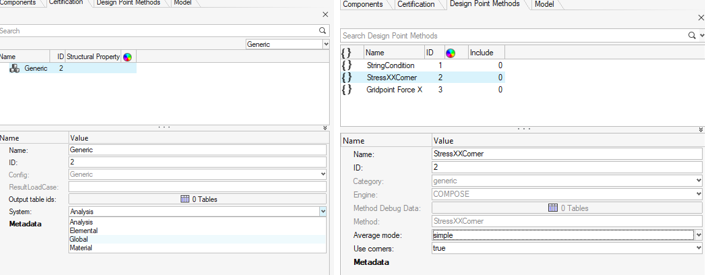

Before running, check for each Designpointmethod in the Certification Browser system used for data extraction.
- Analysis
- Global
- Elemental
- Material
It is also possible to define a user system for result extraction. If a defined extraction system is not compatible with data query, then the Global system is used instead. Some configurations do not allow Material system.Figure 3.
For each Designpointmethod to run, first check the options:- Corner
- Average mode
