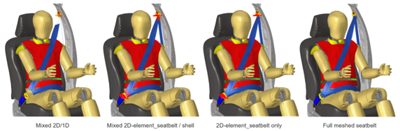

Figure 1. Mesh Types for LS-DYNA

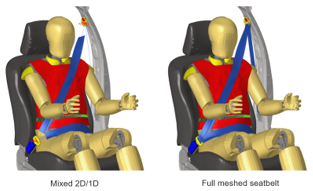

Figure 2. Mesh Types for Radioss

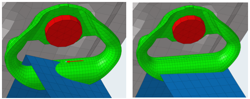

To modify the belt path and end vector orientation, select the seatbelt entity
in the browser, right-click and select
Interactive modification from the context menu.
Interactive Modification lets you interactively move the seatbelt path on the graphic to the desired location.
To modify the belt orientation at start and end, in the Entity Editor, under Geometry Definition, pick the
appropriate nodes in the Vector at start and Vector at end fields.
