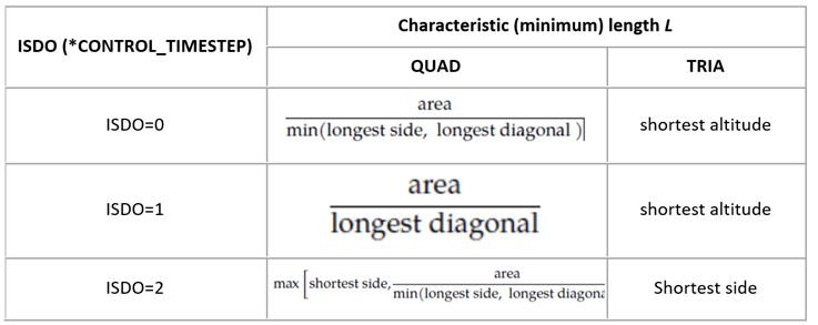

Critical Time Step for Shell (2d) Elements

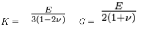

Critical Time Step for Solid (3d) elements
Where E is Young's modulus, ρ is Material density, 𝜐 is Poisson's ratio, K is Bulk Modulus, and G is Shear Modulus..

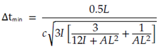

Critical Time Step for Beam (1d) Elements
Hughes-Liu beam and truss elements, the time step size is given by:
Where E is Young's modulus, and ρ is Material density.
Where I and A are the maximum value of the moment of inertia and area of the cross section, respectively.
