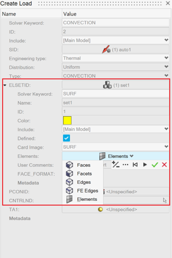

Thermal Card Improvements
- CHBDYE, CONV, and PCONV are now organized as set segment, load, and property entities respectively.
- Conduction grouping is removed a “Heat Flux” has been added for appropriate
organization.
- CHBDYE can now be defined with a set segment entity consistently with OptiStruct solver definition. For example, defining CHBDYE on 2D
edges.
