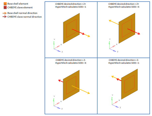

CHBDYE Side Conventions for 2D Elements
For CHBDYE secondary on 2D shell elements, HyperMesh will automatically assign a SIDE parameter value of 1 (top) or 6 (bottom), depending on CHBDYE normal direction. Use the Normals panel (Tool page) to change CHBDYE normal direction.

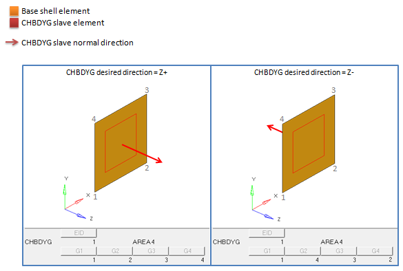

CHBDYG Side Conventions for 2D Elements
