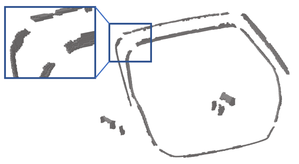

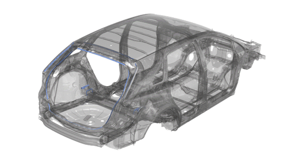

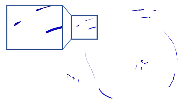

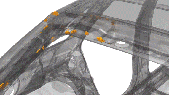

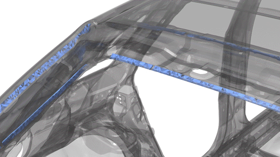

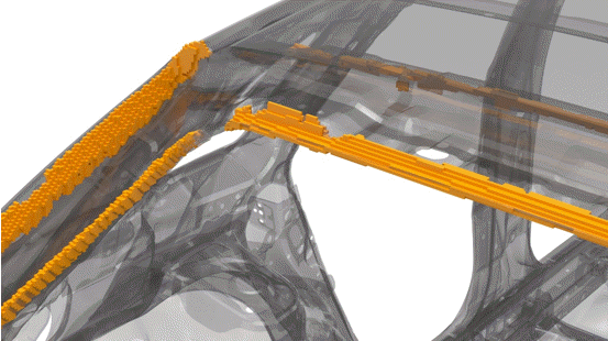

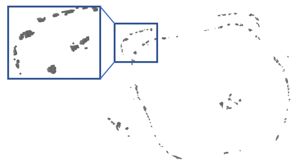

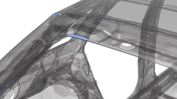

Figure 1 shows a sample automotive model with structural adhesives used to improve stiffness, but the adhesive length is not optimized. Figure 2 shows original adhesive being converted to an Adhesives design space using the process described on this page. Figure 3 and Figure 4 show structural adhesives before and after optimization respectively. The performance of the optimized model shows similar performance benefits, but it saves a significant quantity of adhesives.
The Adhesives tool automatically identifies flange locations from the selected entities. It also creates TIE-based contact between the Adhesives design space (voxels) and the structural elements nearby. It does not add any additional stiffness as it will not create contacts between structural parts. Like Global and Local design spaces, Adhesive design spaces creates a topology design variable.-
