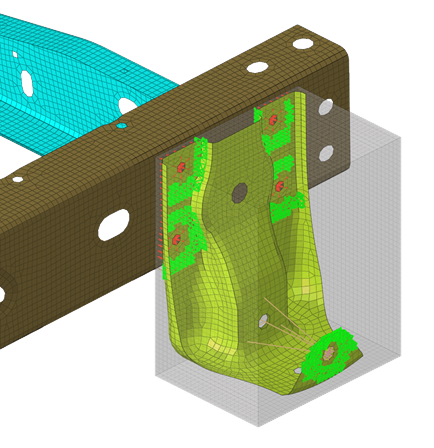

For the guide bar, select an input.

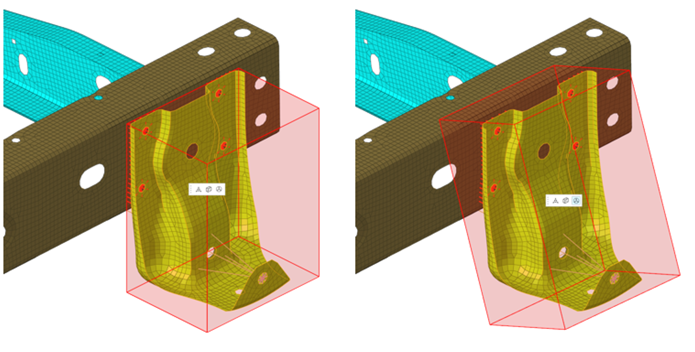

A bounding box preview indicating where the design space will be created is displayed in the modeling window.Note: Use the microdialog to move or resize the bounding box. You can also use Autofill to locate the bounding box globally or aligned to the principal axis; depending on the input, one may be better than the other.

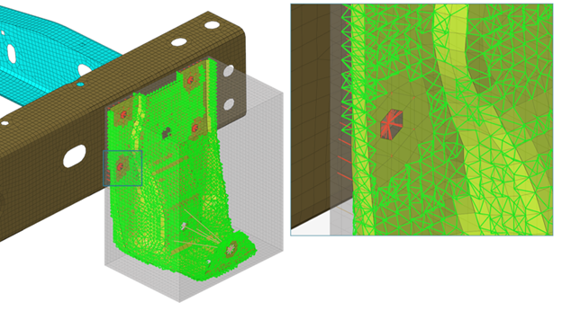

Select Connect All.
If Connect All is selected, individual hard points will not be considered and the whole design space will be connected via RBE3s to the initial selected input.
Figure 4.
If Connect All is not selected, it is possible to select individual nodes which are defined as hard points and the RBE3 connectivity will connect to the local surrounding elements. The number of rows of connected elements can be controlled, default is two rows. In Figure 5, all five hole hard point locations are selected.
Figure 5.

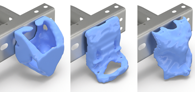

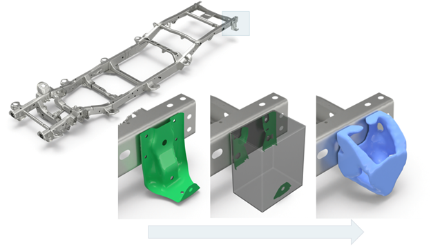

Upon creation, the voxel design space is created along with the design variable (DTPL) and PSOLID property. Once the responses, objectives, and constraints are defined, the topology optimization can be performed.
- Left: full design space, solid with symmetry
- Center: manually reduced design space, solid with symmetry
- Right: full design space, stamp thickness with symmetry
