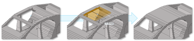

Click-and-drag graphical manipulators to reposition the faces in the selected
direction(s), or enter a precise value in the microdialog.
- Translate along an axis by dragging arrows.
- Translate within a plane by dragging squares.
- Specify a precise magnitude to translate or rotate by clicking a graphic manipulator and modifying the value(s) in the microdialog that opens. Press Enter to execute the move.
Dragging in the positive direction changes the preview of the selected faces orange, whereas dragging in the negative direction changes the preview red.
If the voxels are dragged and overlap with a pre-existing voxel, they are not duplicated and all voxels will be equivalenced correctly.Figure 3.

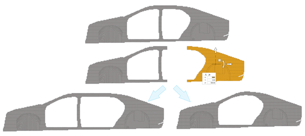

Example: Edit Voxel Meshes

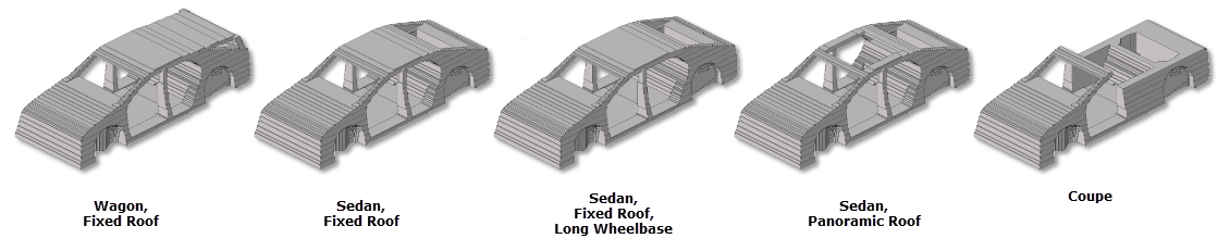

Example of an original voxel output being altered to become a long or short wheelbase using a combination of HyperMesh tools.
Editing voxels outside of the Voxel tool is possible; however, this is only possible when the distance is a multiple of the voxel size. For example, if the voxel size is 10, then the distance to drag the faces must be 10, 20, 30, and so on. If large scale changes are required it is possible to delete, move and then edit the voxels.
