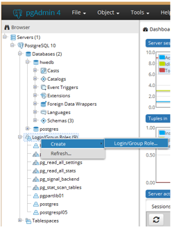

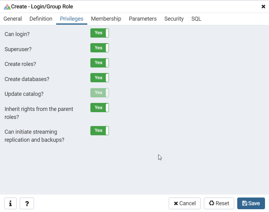

Launch the pgAdmin 4 tool (included with the installation) in admin mode, and
add one user with full rights:

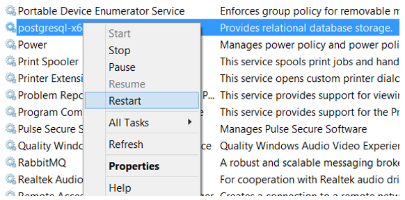

- Using Windows Explorer, locate the pg_hba.conf file that you created in the previous step and move it to the <PostGres_INSTALLATION_DIR>/data folder to replace the file already there.
- Open the Windows Task Manager, Services tab, and locate the postgresql-x64 service.
Restart the postgresql-x64 service by right-clicking on the service name and
selecting Restart from the context menu.
