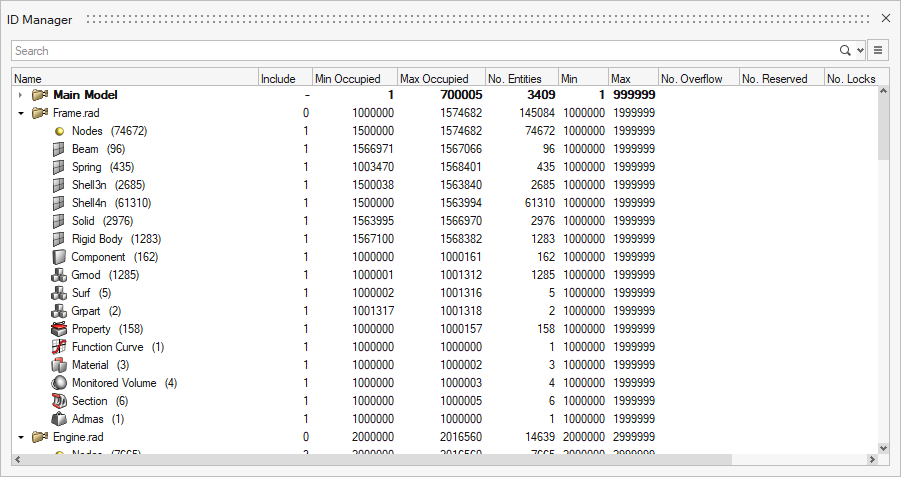

ID Manager Dialog
Overview of the ID Manager user interface.
| Option | Description |
| Allow Duplicate IDs on Correction | When enabled, duplicate ID pool's for supported entities are permitted to have the same IDs. |
| Name | Displays the Main Model, Includes, and the child entity types within them. |
| Include | For entities, displays the ID of the include in which they are organized. |
| Min Occupied | Displays the minimum ID occupied by all of the entities in an Include file. For individual entities, it displays the corresponding minimum ID occupied in the Include file. |
| Max Occupied | Displays the maximum ID occupied by all of the entities in an Include file. For individual entities, it displays the corresponding maximum ID occupied in the Include file. |
| No. Entities | Displays the total number of entities in Include files and entity folders. |
| Min | Enter a minimum integer value for the ID range that does not overlap with any other range definitions in the model. |
| Max | Enter a maximum integer value for the ID range that does not overlap with any other range definitions in the model. |
| No. Overflow | Displays the number of IDs in an Include file or entity folder that are outside of the defined range. |
| No. Reserved | Displays the number of IDs reserved at the entity level. If an entity type supports ID pools, the #Reserved column will display the total number of reserves applied to each ID pool in that entity type. |
| No. Locks | Displays the number of IDs that have been locked from renumbering. |
| New ID | Determines where new IDs will be placed within the current Include file range.
If the ID Manager cannot find any free IDs using the After Max and Before Min options, then newly created entities will be assigned IDs using the Fill in Gaps option. If the ID Manager cannot find any free IDs within the defined ID range using any of the above options, then newly created entities will be assigned IDs beyond the Max ID occupied or the Max ID defined in the model, whichever one is being the highest. |
| Correction | Determines how duplicate IDs are renumbered to correct overflow.
Note: IDs that are locked or reserved in an Include file will not be
renumbered. |
| Advanced columns default off: | |
| ID | Displays the ID of the Include file. |
| Excluded | Displays an X icon ( ) when an entity is excluded from ID
management operations. |
| Offset | Displays the ID range offset for a solversubmodel. |
| Min Reserved | Minimum integer value for the reserve ID range. You can manually edit the Min
Reserved column as long as your modifications do not violate the Min and Max ID
range. When you reserve all IDs, the Min Reserved and Max Reserved columns are populated using the Min and Max ID range defined at the entity level. |
| Max Reserved | Maximum integer value for the reserve ID range. You can manually edit the Max
| Conflict | Displays a conflict icon ( |
| No. Conflicts | Displays the number of conflicts in a reserve range. |
| User Status | User defined status indicator which can be manually set to show the status of
reserve conflicts.
