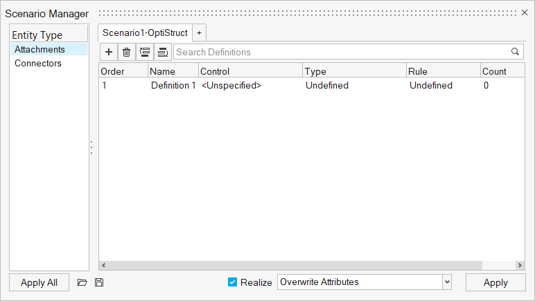

From the Assembly ribbon, click the
Scenario tool.
Upon opening the Scenario Manager, an initial scenario is already available. - Optional:

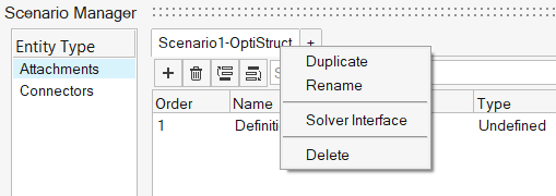

Right-click on a scenario to duplicate, rename, change the solver interface, or
delete.
The solver interface filters the available controls. This ensures that the scenario is in a single solver.
Figure 3.

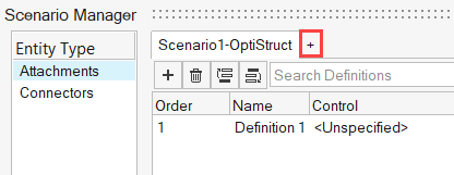

Click
to create additional scenarios.Figure 4.

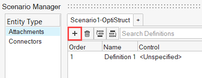

Click
in the active scenario tab to create new definitions.
Figure 5.
Similar to scenarios, right-click on a definition to rename, review, control the display, and delete.

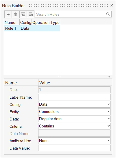

Right-click on Rule column and select
Edit. Use the Rule Builder to
dynamically determine which engineering entities that a given control is applied
to.
The rule can be created based on Data on the engineering entity, by Shapes, by Selection, or All.
Figure 6.
