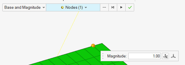

Option Description Base and magnitude - Select one or more nodes, FE edges, or faces at which to place vectors.
- Define a magnitude.
- Optionally, click
to assign the vector to a local
coordinate system.For example, if you define a vector in the global z-direction, then assign a system, the result will be a vector pointing in the z-direction of the local system.
- Click
to adjust direction components with
the Vector tool.

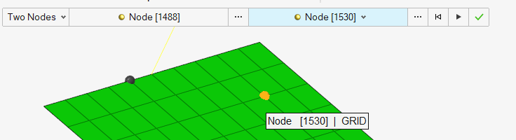

Two nodes Select two nodes or locations to create a vector from node one to node two. Figure 3.

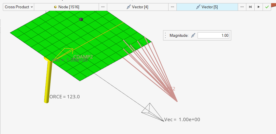

Cross Product - Select a node or location at which to place the new vector.
- Select two existing vectors to derive a perpendicular vector.
- Enter a magnitude or inherit the magnitude of one of the two selected vectors.
Figure 4.

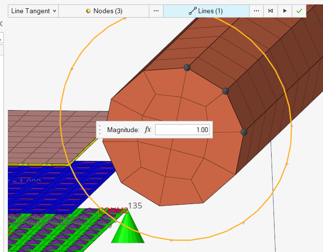

Line Tangent - Select a node, face, or edge at which to place a vector.
- Select lines to create tangent vector projections.
The resulting vector(s) will be created on all nodes selected.
- Enter the magnitude or calculate it automatically using parameterization. For a curve tangent, this is the value of the parametric curve derivative.
Figure 5.

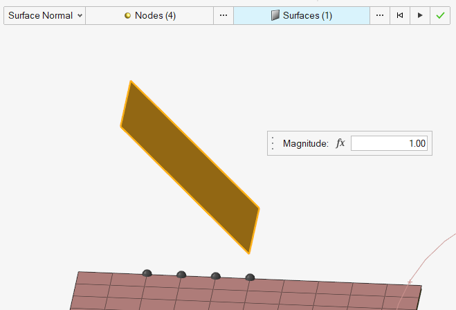

Surface Normal - Select a node, face, or edge at which to place a vector.
- Select surfaces to create normal vector projections
- Enter the magnitude or calculate it automatically using parameterization. For a surface normal the value is defined by the length of the cross product of the surface parametric derivatives.
Figure 6.
