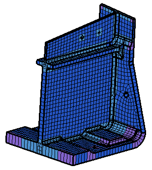

Thickened Shell Comparison
- CAD
- Matched
- There is no criteria for matched surfaces in a thickened shell comparison. However, a value is provided by dividing the matched FE area by two. Surfaces are set to 100% matched if the FE is also 100% matched. Surfaces are never categorized as matched, though, as the overlapped match type is the maximum category.
- Overlapped
- Occurs when all points of a surface are within the tolerance of the elements (when offset is projected by thickness). The element edge nodes that are not within the tolerance of a surface edge may be projected on to the surface. This is calculated by dividing the overlapped FE area by two.
- Intersected
- Occurs when at least one point of a surface is within the tolerance of the elements (when offset is projected by thickness). This value is adjusted to make sure the percentages add up to 100%.
- FE
- Matched
- Occurs when all of an element's nodes (when offset is projected by thickness) are within the tolerance of a surface on both sides. If a node is lying along the edge of a mesh, it must also be within the tolerance of a surface line on at least one side.
- Overlapped
- Occurs when all of an element's nodes (when offset is projected by thickness) are within the tolerance of a surface on both sides, located over an ignored hole or slot, or within the internally calculated distance of the root of a fillet (any t-intersection or bend in the mesh of at least 44 degrees). If a node is lying along an edge, it must also be within the tolerance of a surface line on at least one side, located over an ignored hole or slot, or within the internally calculated distance of the root of a fillet.
- Intersected
- Occurs when at least one of an element's nodes (when offset is projected by thickness) are within the tolerance of a surface on at least one side, located over an ignored hole or slot, within an internally calculated distance of the root of a fillet (any t-intersection or bend in the mesh of at least 44 degrees), or within the tolerance of any surface edge.
