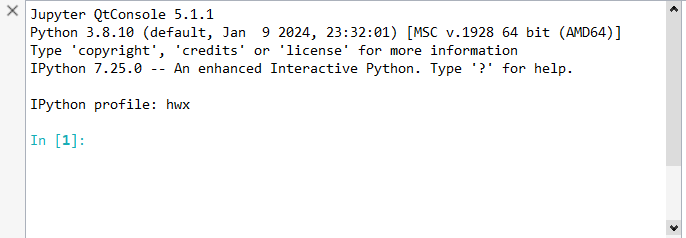

Launch the Python Console in MotionView
- Launch a new MotionView session.
- Click .The Python Console window is launched.

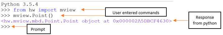

Python Console Conventions
Importing mview Package
In order to create, modify, and interact with the MotionView
modeling entities through python, the mview package needs to be imported
first.
>>> from hw import mviewCreating and Modifying Entities
